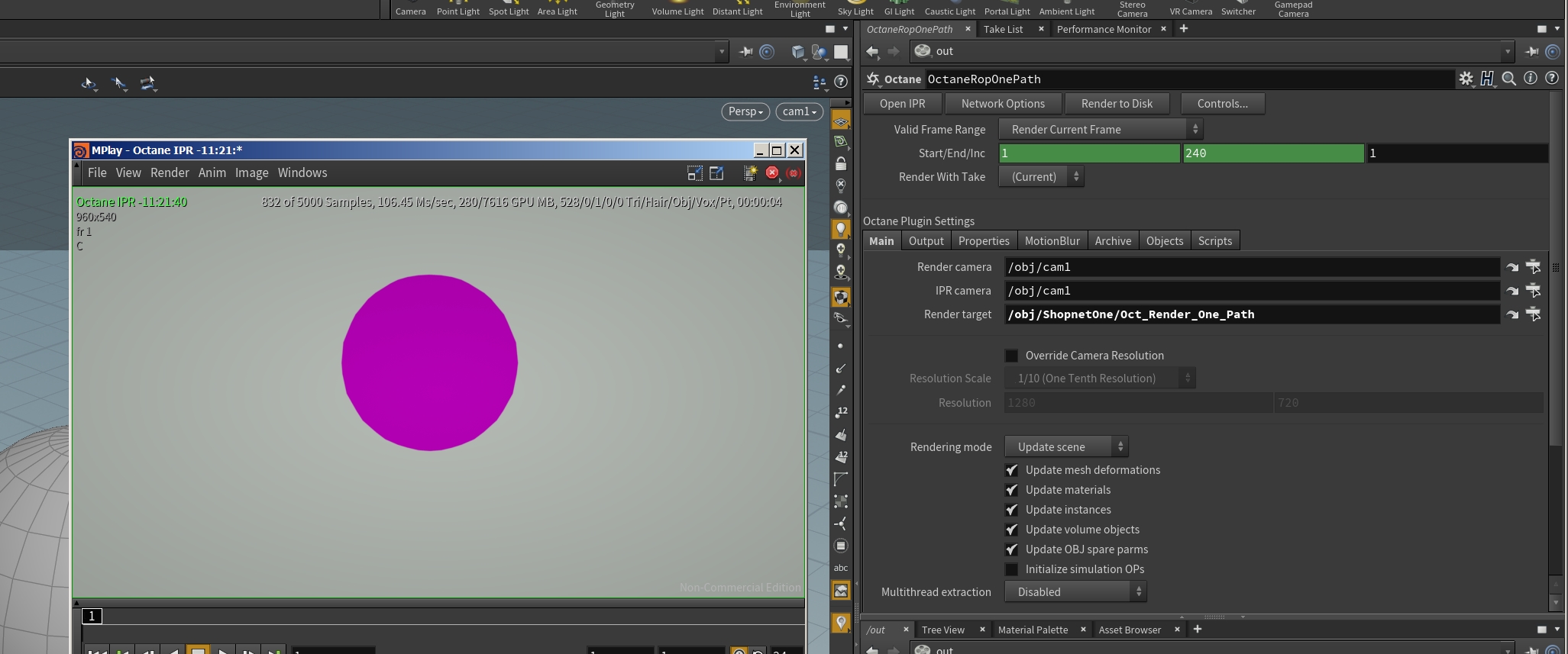

I am learning Houdini so this may be a Houdini error question not a plugin question but here goes.
I am assigning the thin lens camera to the custom render target and assigning the render camera and IPR camera to that thin lens camera... but every-time I do an IPR it says it can't find the camera.
Also my IP window is missing all the octane tabs.
Any ideas
Many Thanks
Peter
I am running Houdini 16.5.268 and Octane 3.08 test 6 on Mac OSX 10.13.1 on a GTX 1080
Zip of file and screenshot attached
HoudinForum_File.zip
(6.1 MiB) Downloaded 290 times
juanjgon
Posts: 8867
Location: Spain
The camera object that you must set in the ROP is the Houdini camera, not the Octane camera node used in the render target, that is used only to configure the camera properties. Perhaps you should check the brief tutorial available in the docs to know the basics of the plugin workflow:
https://docs.otoy.com/HoudiniH/HoudiniP ... eScene.htm
Be aware that in OSX the IPR works inside the Houdini MPlay application, not using a custom window.
Thanks,
-Juanjo
