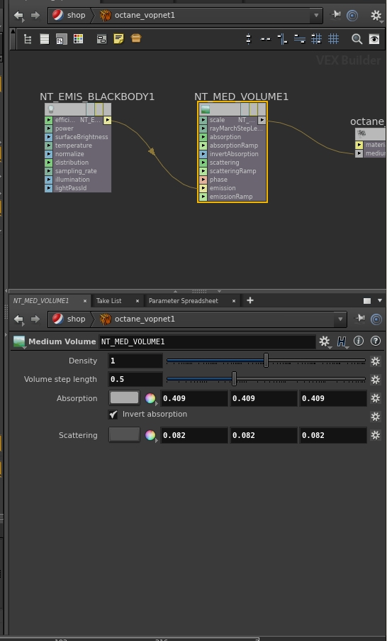

The kernel nodes don't have now the volume step option, this feature is now available in the volume medium node, that is the node that you should use to render the volume objects. I will try to post a sample scene ASAP.
From the release notes:
- Moved the volume step length from the kernel node to the volume medium node. This allows you to tweak the value for each volume and depending how close and how big they are.

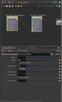

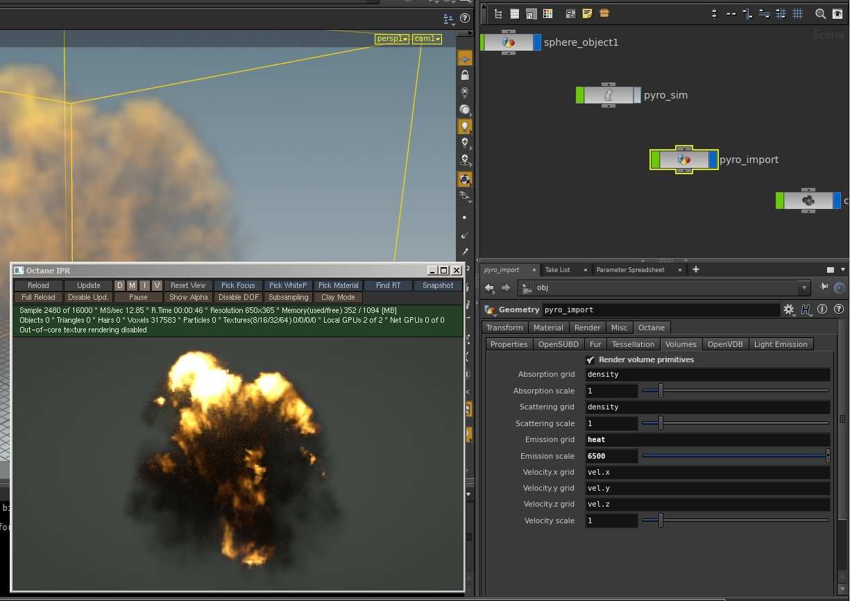

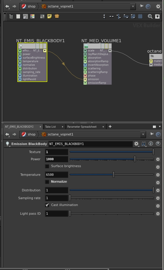

Attached you have a Houdini volume object sample scene and some screen grabs about the settings used. I will update all the plugin docs with all the new Octane 3.0 features along the next weeks ;)

One important trick to render emissive volumetrics is to disable the "Normalize" option in the emission node. Also be aware that the emission temperature is extracted from the emission grid, this is why we must scale it in the OBJ spare parameters. I am using the heat grid for the emission, not the temperature one.

So the only issue was scaling temp from obj node and use heat instead of temp
