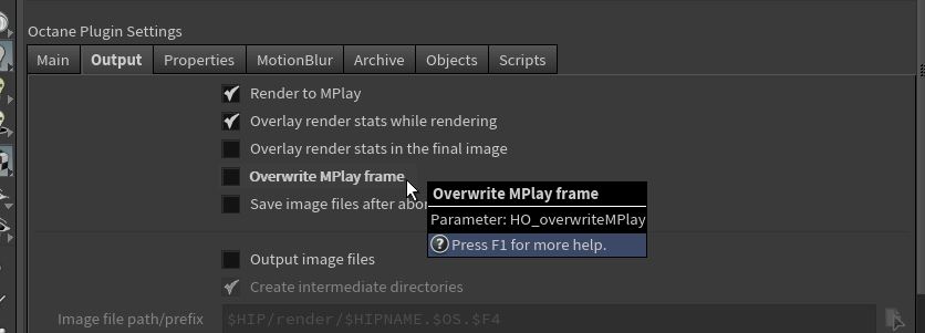

How do you get octane to render in mplay so that you can watch/check the render while its active? Currently, I just have 1 frame showing in mplay even though overwrite mplay and forced update are checked. How do I get it to render similar to the RS plugin does in mplay?
https://share.getcloudapp.com/JruWv4vN it just shows '1' and the current image updates as it's active.
I am using the 20201.0.2 build currently.

You need to disable the "Overwrite MPlay frame" option in the Octane ROP.
