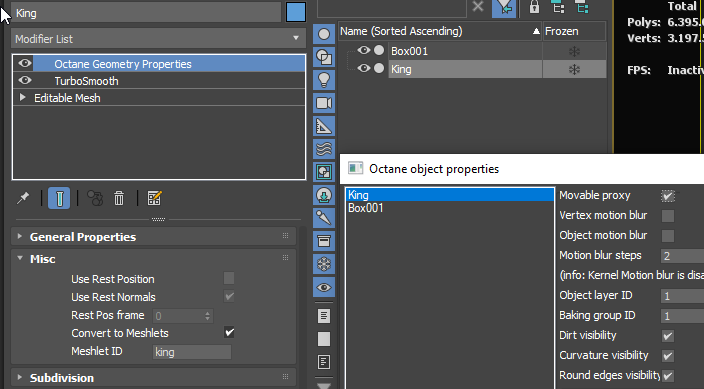

Meshlets in 3dsMax plugin:
Meshlet can be enabled by adding an Octane Geometry Properties modifier, and checking the 'Convert to Meshlets' box in the Misc rollup:
Enter a unique string as Meshet ID, to ensure that Octane engine can load the correct cache file.
The object also need to be set as a Movable proxy (Octane object properties).

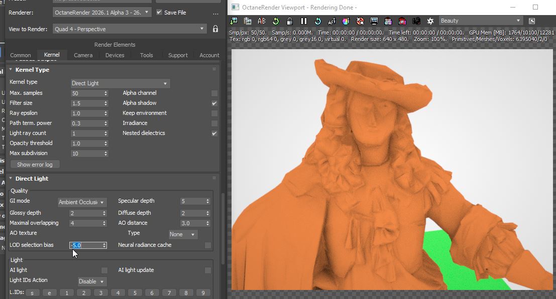

Note: While rendering, you should notice that the first few frames are rendered with a lower resolution mesh.
'LOD selection bias' has been added to influence the LOD data selection. (Render settings, Kernel tab, render Kernel rollup (eg Direct Light))
Decreasing its value, will make the loaded LOD data cruder, increasing its value will make the loaded LOD data finer. The default is 0.
Here are some results with values 0, -5, -8
