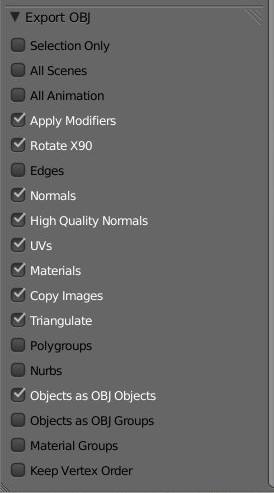

Obj export settings for Blender 2.52 Build 29778.
Cheers mib
