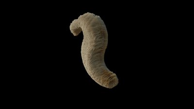

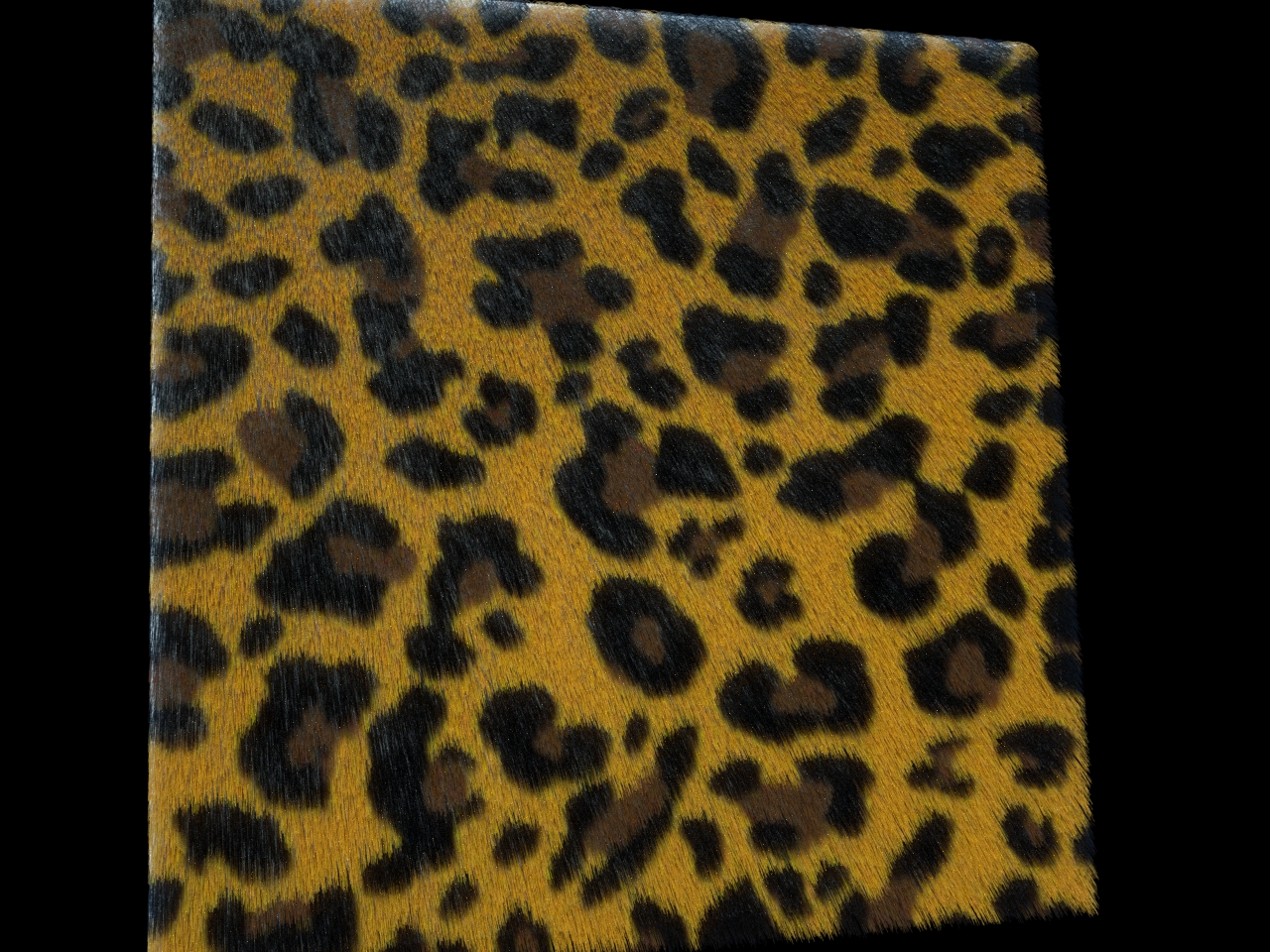

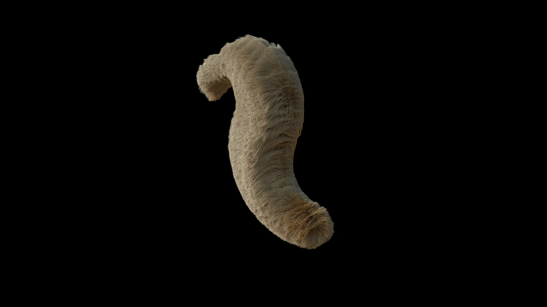

Been having a go. Here are some things. First one is from the content. Second is just an attempt to colour the fibres based on UV
So can we not do different colours along the length of the fibre?

coloring fibres along the length of the fibre is not supported yet but there is a way around it
use dirt node as a mixer input to mix two colors, close to the tip dirt node will give white and close to the root dirt node will give black. Use this value to mix two colors, one for the root and on for the tip.

well I just told you, use a gradient to control the thickness of a fibre just as you would in vanilla lw rendere and it works
it is the fibre width under geometry tab in fiberfz
