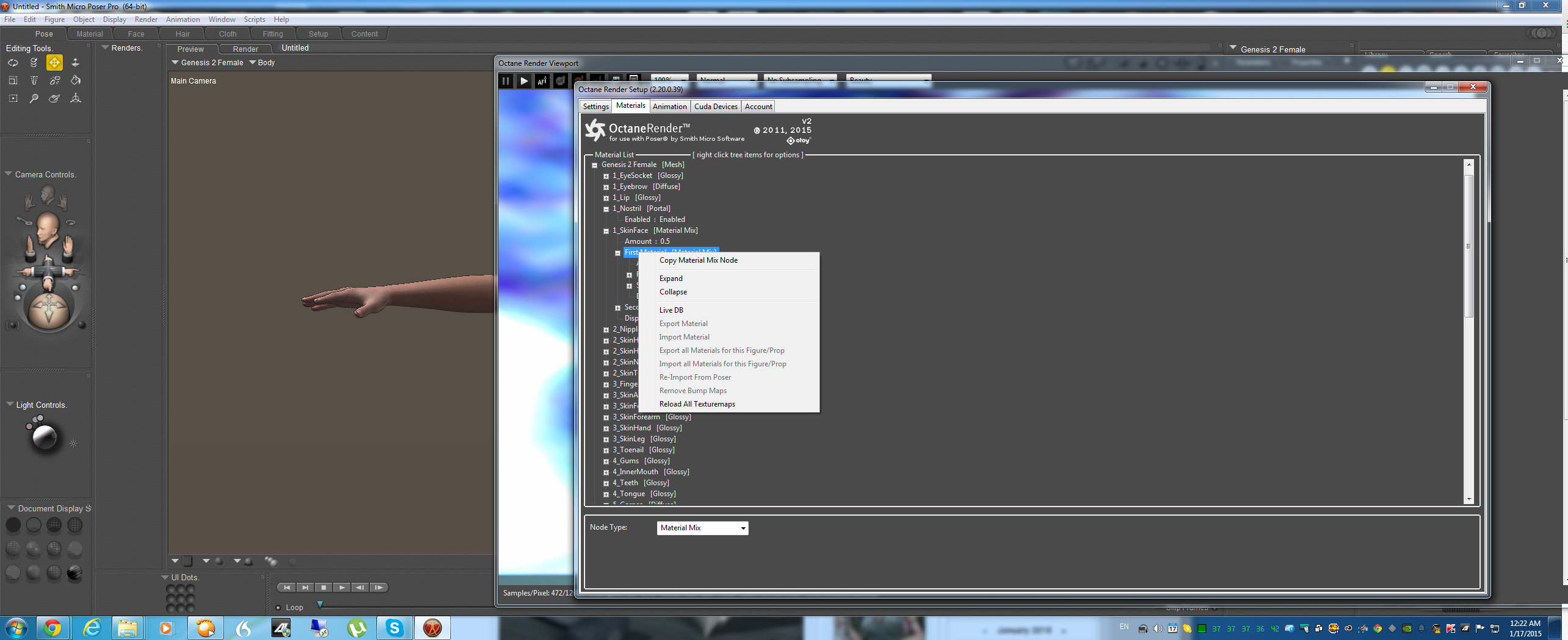

think I found bug. look like you can no longer import poc poe files .
on Genesis 2 female looks like you can no longer import
Rightclick the figure in the tree to import/export all materials, or rightclick a material to import/export a single material.
Paul
