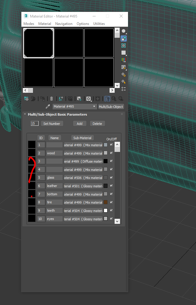

Sometimes when max crashes and scene is reopened all materials are black in the editor

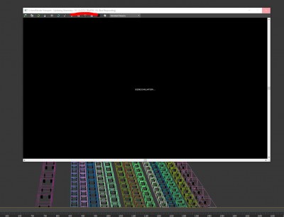

Hi Paride,
were you to reproduce stuck on evaluation/slow eval. When we have a lot of cloned cars as instance octane stuck on eval
it seems that it evaluates 3ds max instances like copies very slow. It now eventuates as slow as octane 3 again
I have 10 unique cars total poly count is 2 mil. If I clone then 50 times as INSTANCE it wont even render. stuck on processing even thought these are instances
I attached another video. I just don't understand why 3ds max copied instances are so slow. Itoo forest with thousands of instances loads in seconds. This is in both rc6 and rc7. I though some versions started to speed up geometry processing now it is back to slower than v3
And as I mentioned earlier the scene only uses 0.9 GB
UPDATE:
Ok I did some previous versions tests. So it takes RC6 and RC7 3 min 14 sec to open 50 instances (1GB vram)
RC4 takes only 1 min 50 seconds to open 50 instances (1GB vram). Still very slow for just 1 Gb of vram but newer version got even worse. This is far from what they said 20mil polys in under 5 seconds. Please otoy fix it. Denoiser won't matter if I spend 2 min per frame just processing geometry. I am not sure what to even think about real time brigade rendering anymore
