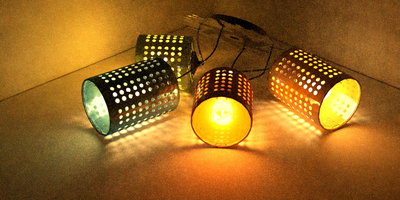

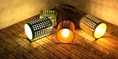

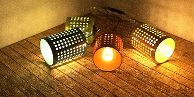

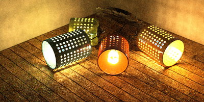

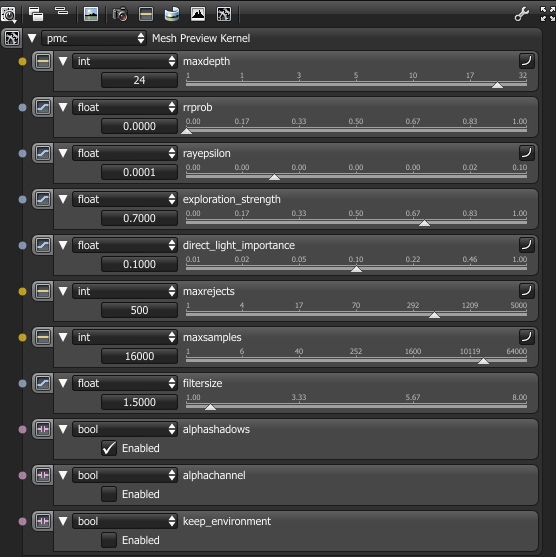

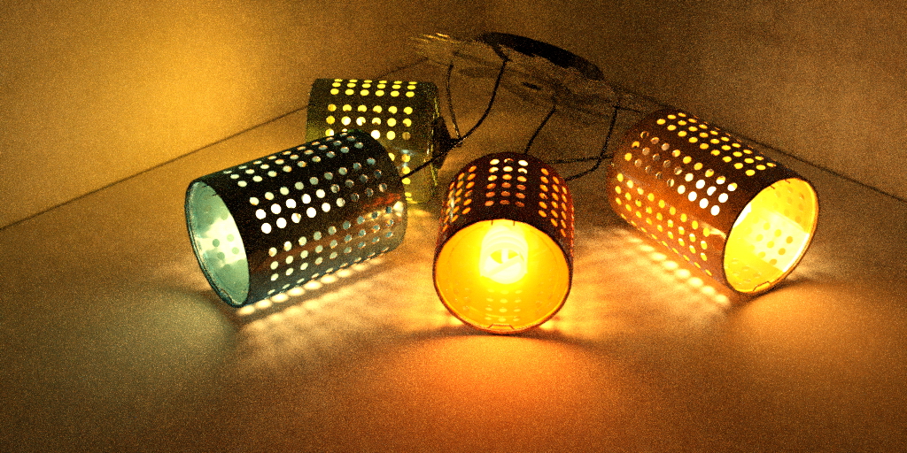

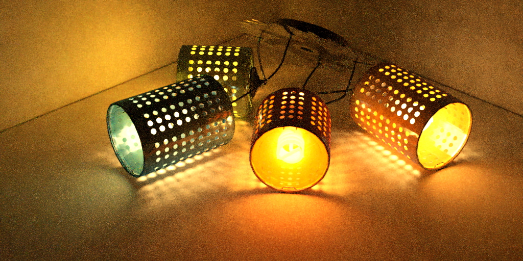

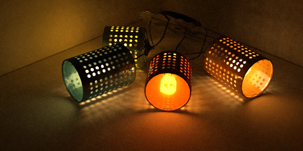

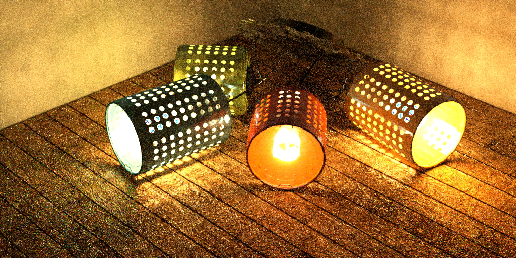

some more tests, dunno why but this one has proven a tough one to solve cleanly.
PMC and PT glass has 0.7 opacity and 0.012 disspersion.
It could be the wood table's bump, I'll try with a flat white later.
Any ideas?
update:
the images are actually in inverse order timewise, I've tried using a white diffuse material for the table (3rd and 4rd shots) and later I've change the disperssion values of the glass back to 0 (1st and 2nd) it seems without dispersion it looks better, and also with a lower iso and higher fstop values it "hides" somewhat the noise.

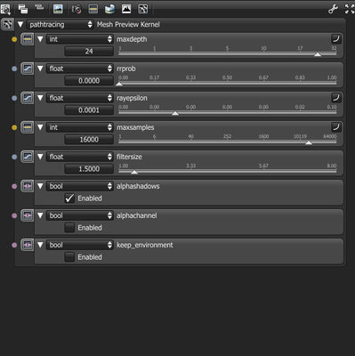

Added the render kernel values
the last 4 renders have the exact same values in everything except render kernel. Then I adjusted the light emmiters 'cause they were too bright (the next "batch" 1-4) and changed the material for the table, then I changed the glass dispersion, same PMC kernel used in all of them, and PT kept the same values.
PMC white table 5700 samples 1:54 hr and hotpixel 0.55 glass without dispersion lower iso
PMC white table 5700 samples 1:54 hr and hotpixel 1.00 glass without dispersion
PMC white table 5324 samples 1:47 hr and hotpixel 0.60
PMC white table 5324 samples 1:47 hr and hotpixel 1.00
PMC 8760 samples 2hr16min, hotpixel 1.0
PMC 8760 samples 2hr16min, hotpixel 0.1
PT 4650 samples, about 1hr, hotpixel 1.0
PT 4650 samples, about 1 hr, hotpixel 0.3

kubo wrote:some more tests, dunno why but this one has proven a tough one to solve cleanly.
Any ideas?
Did you render both images in beta 2.47 with the same maximum depth? This is very important for any comparisons, and the PT result differs greatly from the PMC result. What was the maxrejects you were using PMC?

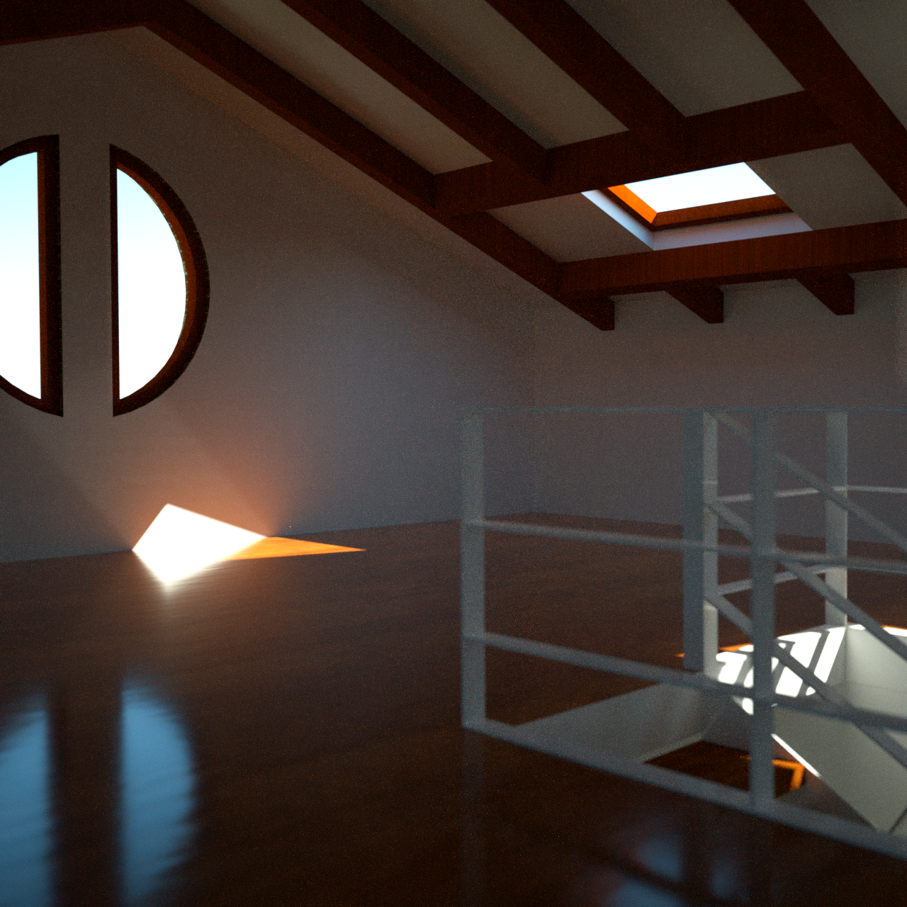

simple interior scene only lighted with sunlight.
1300 samples in 6 hrs on my laptop at approx the same rate of pt.
very good indirect light and nice reflections never achived before with pt.
thank's you guys for the improvement .....

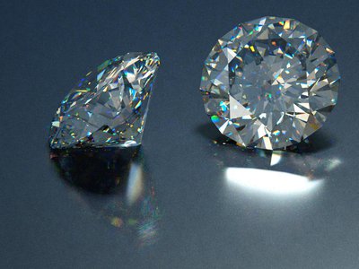

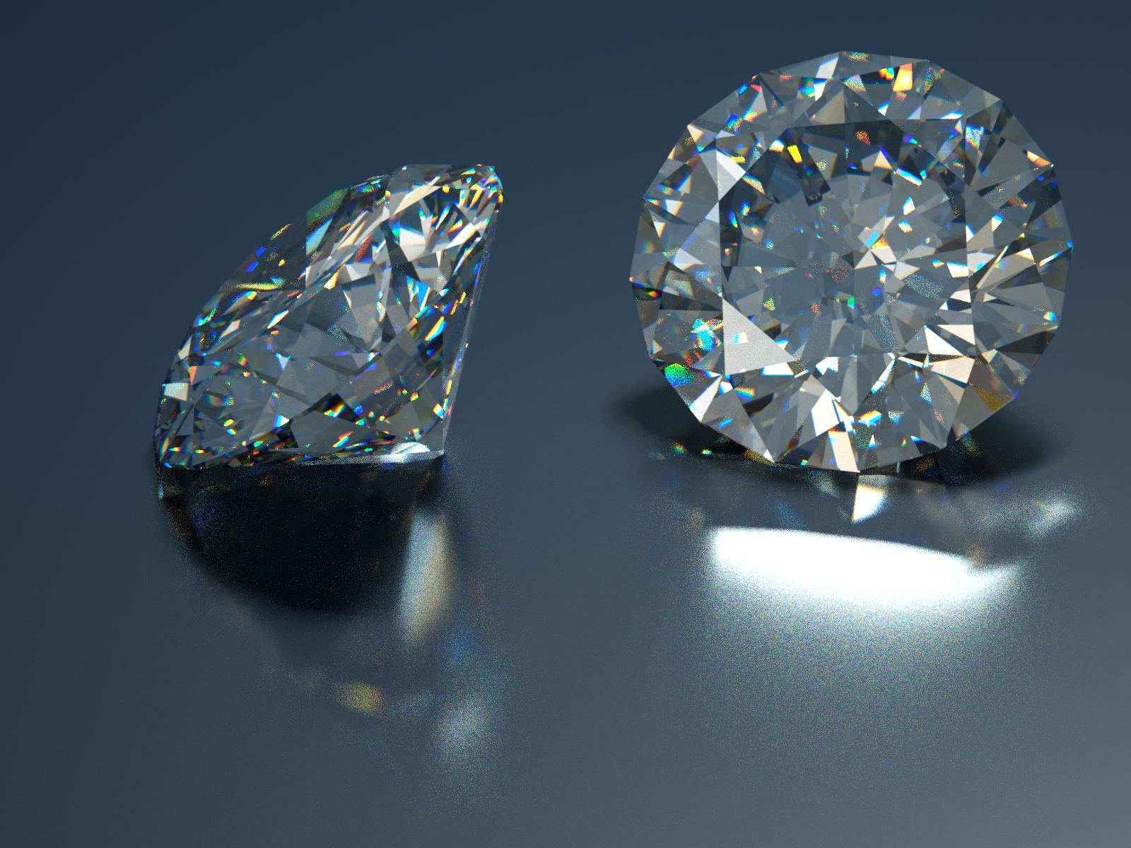

Test with 3mm diameter Brillant (Diamond standard cut - Refract 2.418, Dispers 0.044) + simple low emitter (dist. 30 cm top back)
PMC 225 samples, 20min:
PT 225 samples, 4min12:
PT 1340 samples, 25 min (:
Pathtracing is really faster than before; and its my prefered for instance as effect in object is near same as PMC
even after 25 min caustic cannot be same; but I will test brillant included in gold jewellery...
Edit: no post process, brut from Octane.
