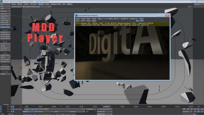

testing our MDD with LW-Octane renderer but It doesn't seem to work. Bug or not (yet) existing feature?
Edited: F9 does render properly, only the IPR doesn't refreshes. It displays the frame on which you start IPR.

marchermitte wrote:testing our MDD with LW-Octane renderer but It doesn't seem to work. Bug or not (yet) existing feature?
In the current version you need to reload scene or enable the "Full Upd." option in the IPR window to see the changes in any objects with deformations, dinamics, etc.
Next version is going to update the obejects with deformations without reload scene.

Ok, I figured out the reload thing in the end, It's logical. Good to know that this will be implemented in "real time" in the next release.
