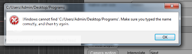

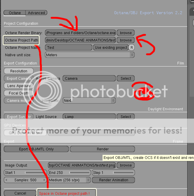

I see 3 places
"Programs and Folders" in binary,
"Octane Animations" in project path and image output.
http://vimeo.com/user2509578
face wrote:I see 3 places

Yeah, look at your paths, there is a space between OCTANE and ANIMATIONS, you cannot have any space in the path except the binary path where it is allowed.radiant wrote:face wrote:I see 3 places

Create a Project folder without any spaces.
The path to the binay can have spaces.

In my last animation test, I had spaces in my binary path, and I got a warning too. So, I think it's better to have no spaces at all.The path to the binay can have spaces.

Indeed, there is a warning when there are spaces in the binary path, I think there is no reason for that so I'll make some more tests to check if I can remove the warning, by the way for now it's required to not have space in the binary too.ROUBAL wrote:In my last animation test, I had spaces in my binary path, and I got a warning too. So, I think it's better to have no spaces at all.The path to the binay can have spaces.

for my own, I have been very happy to see the warning ! It helped me instead of leaving me in front of a failure !
