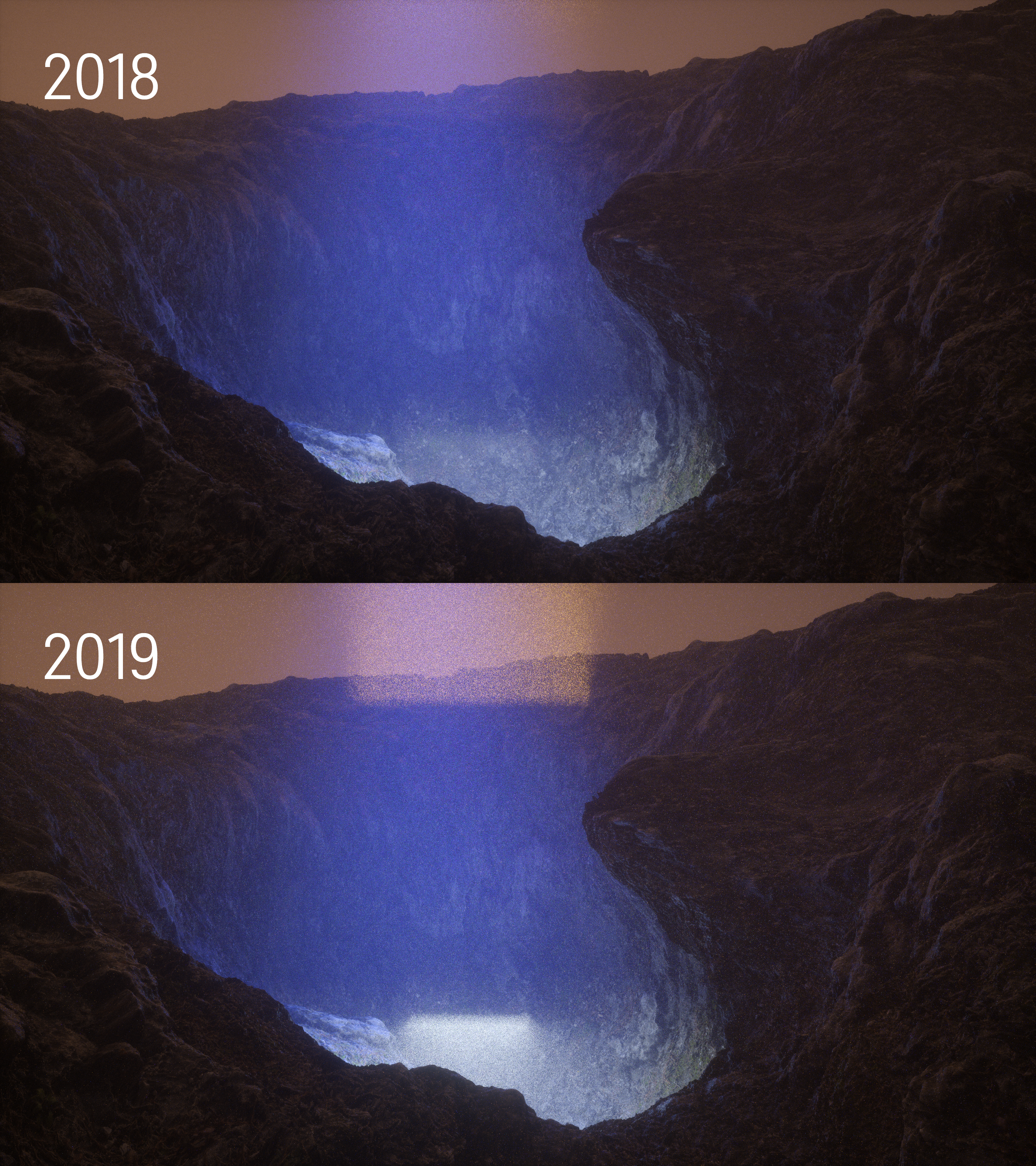

i found some strange differences between 2018 and 2019.1 renders. Light sources now visible in medium in 2019.
https://drive.google.com/open?id=1O8OIJ ... 7j3YiowMgm
