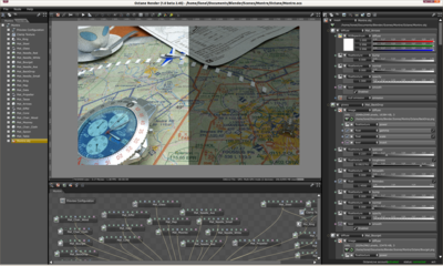

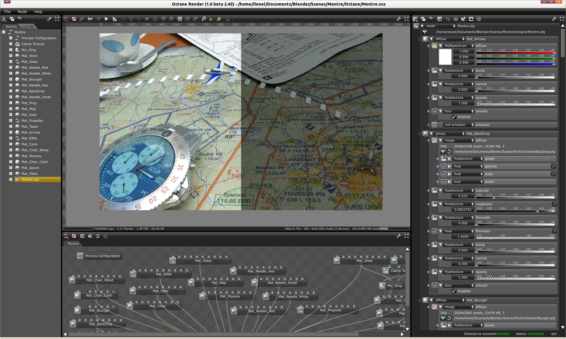

Still some issues in multi-GPU. Note this only happen when the viewport has changed (zoom or move camera). I can render clean images if save/exit/reload and then let run without touching anything. This has happened in the past, so it's not new to 2.45.
Does it always happen or only sometimes in specific scenes? Does the chess scene render correctly? I just tried it here with a GTX 470 and a GTX 460 and it renders fine.

Here's some additional info that might help you:
- demos scenes and small scenes seems to always work fine
- it only happens when the 2 GPUs are activated
- I increased the polys on a working scene and couldn't reproduce the issue (trying to make a relationship with memory usage)
This is not critical for me, just annoying, but I'm curious to know where it comes from.
Configuration:
- GTX295 with 260.19.36 drivers and cuda 3.0
- xorg.conf is set up with Option "MultiGPU" "None"
- desktop resolution 1920x1200x24
- no desktop effects and no compositing
I'll be on holidays tonight so plenty of time ahead if you want I make additional tests (also got dual-boot to W7 available if you need I try to reproduce on Windows).

Hi Lionel,
Thanks for your efforts. I tried it on Cent OS. I while ago I have seen something similar: Different auto-focus settings for both GPUs and similar weird effects. Unfortunately this went away after the next Octane launch and never came back, so I'm not exactly sure what went wrong since I couldn't reproduce it.
It would of great help, if you have a scene where this problem is reproducable.
