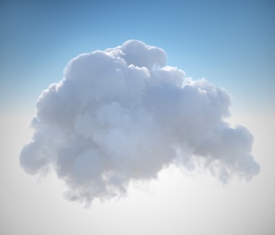

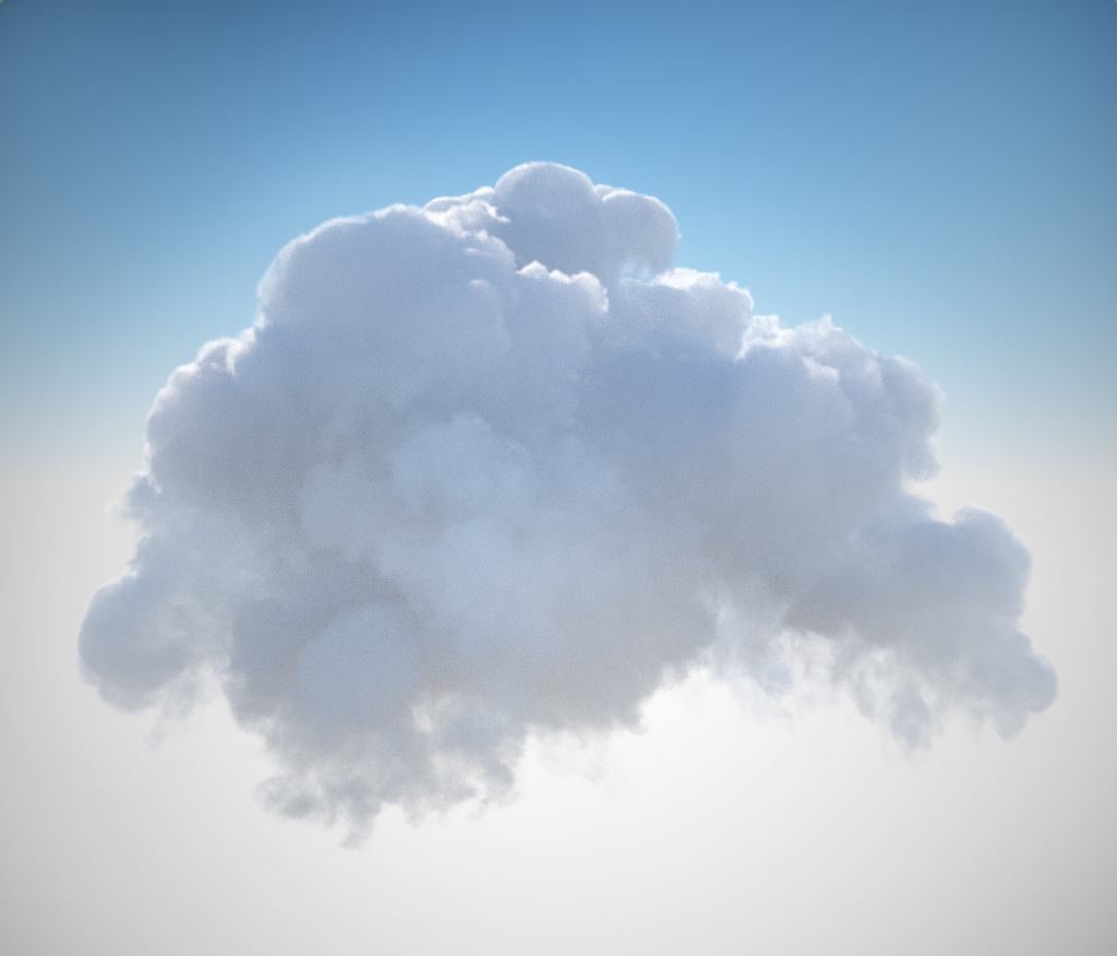

really liking the shading and playing with the phase....cant wait for those ramp controls.
Is there any plans to support Mblur for volumes (via a 3 "vel" volumes for example)?how will this affect memory?Thanks again guys.

miko3d wrote:really liking the shading and playing with the phase....cant wait for those ramp controls.
Hi Miko, very nice renders. Yes we will support motion blur for volumes in two different simultaneous ways. First, the typical motion blur you see with animated mesh geometry, and second with the render time advection "vel" grids. The latter will most likely come first.
For a typical fire VDB, you've got a density grid and a temperature grid. These are independent floating point grids, and share a very similar topology. We merge and load these into a single hierarchical grid to conserve as much space as we can. If you add motion blur from these 3 separate velocity grids, then each voxel will go from storing 2 floats to 5 floats, more than doubling the memory usage. Nonetheless we will be implementing this, but if you don't use motion blur, then it won't affect your memory usage (ie. we don't load data onto gpus that isn't used).
