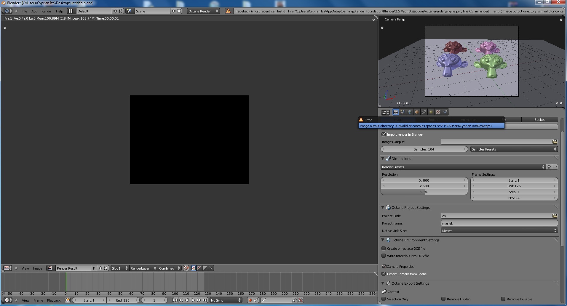

I have this problem: I'd try save file on C: or on desktop in folder and always I have this error .Something is wrong
steveps3
Posts: 1118
Joined: Sat Aug 21, 2010 4:07 pm
Location: England
That is because you have the "Import render in blender" checked but have not specified a image output path.
