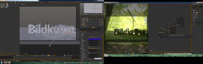

Sorry i cant find the environment-topic here.
I have problems to rotate my enironment-map.
The only working node setup is a Rotation-Transform conneced to the the image-texture.
And with this i can only rotate around the horizontal z axis (3rd input value).
The other inputs doesn´t change anything :/.

MattRM wrote:For the rotation of env, I know the answer, you need to use translate on x.
Matt
Would be great..but.. i told you there is only one thing that works ;).
There is no pure translation-node.
I have
a rotation-node
a scale-node
a full-transform-node
I´ve tryed the full-transform node and checked all axis. No one does do anything.
WIN7 64bit • 32GB DDR5 RAM • Intel i7 6x4GHz • GeForce GTX780 • Blender
MattRM
Posts: 199
Joined: Wed Jan 27, 2010 6:06 pm
Location: Luxembourg
Matt
I have
a rotation-node
a scale-node
Arf... was working for me...
Matt
dafassi
Posts: 110
Joined: Wed May 01, 2013 7:04 pm
Location: germany
Maybe im doing something wrong?
