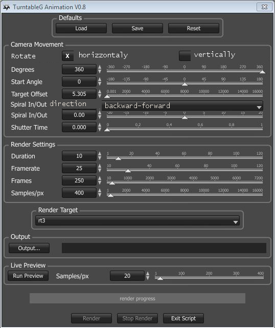

Posts: 10548
hi jason,
thanks for the update, i was waiting for the 1.26 especially for the 0.8 version of yours fantastic script :)
now all the render targets in the scene are correctly listed, even if a thin camera node is grouped or the rt is grouped itself, great ;)
anyway there is still an issue, if you switch from an rt to another for fast previewing, the rt is updated only if the "old mesh preview render target" is selected, any other rt gives always the same rendering of the first rt selected.
another little issue is that, after the exit of the script, you need to click "stop render" and clean all the gpu in order to reload a new render target.
i have prepared a little scene and packaged with the new .ocp format:
grimm08-02.rar
(5.4 KiB) Downloaded 292 times
i wonder if the selection of one render target before running the script is still needed, now that the script can catch all the rt automaticaly :roll:
about other implementation: i have prepared a rough idea of interface that i would love to have, obviously i really don't know how hard could be to implement it :D
note: in the "Spiral in/out direction" popup we should have: backward-forward, left-right, up-down options.
ciao beppe
