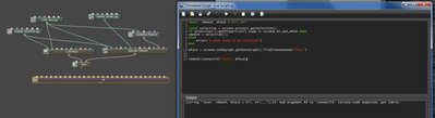

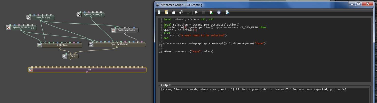

does not work :(
Code: Select all
local  v6mesh, mface = nil, nil
local selection = octane.project.getSelection()
if selection[1]:getProperties().type == octane.NT_GEO_MESH then
v6mesh = selection[1]
else
    error("a mesh need to be selected")
end
mface = octane.nodegraph.getRootGraph():findItemsByName("face")
v6mesh:connectTo("Face", mface)

The error message tells you the problem:
Code: Select all
bad argument #2 to 'connectTo' (octane.node expected, got table)
findItemsByName gives you a list of nodes with this name, not a single node. You can check these things in the API browser (click the button with the question mark). So this second argument should be mface[1].

Thanks!!!
it's worked!
