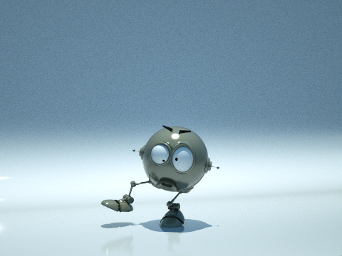

well it's OK for me; rendering well
Working on animation; but no motion blur in rendered images
do you have a tip to make it work?

The motion blur we have, was only camera motion blur, atm.
Octane doesn´t support object motion blur.
oh :(
character animation without motion blur is little more flat in 3D :cry:
but plugin is working well for now; that's the very good news ;)
