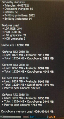

jimho
Posts: 271
Joined: Tue Aug 21, 2018 10:58 am
karu wrote: ...We do consider NVLink as higher priority than OOC...
My observation is a bit different...
in the above image, there should be more than 4G spare space in Gpu 4, yet the pair of GPU3 and GPU4 still use 3.4 G OOC,
this maynot be a good example, actually in many cases I can see there is very small amount of P2P is used but large OOC while there is big spare space is still left in the Nvlink pairs,
at the beginning of this rendering there is arround 3G OOC and 0 P2P
that is the reason Why I proposed the 2.2 and 2.21senario
If really NVlink is at high priority the p2p should appear first then OOC, for instance it is not...
Is the scene you are using very heavy on textures? Currently, only meshes can make use of NVLink (we are planning to support textures in the future). When I said we prioritise NVLink over OOC, that's only for the cases where we have a choice. It might be the case that all the meshes fit onto each GPU without needing to use NVLink or OOC, but then the textures overrun the GPU memory, requiring the use of OOC.

jimho
Posts: 271
Hi Karu,
Thanks for respond,
it is not the case with heavy textures, but as you had mentioned previously, there is one single mesh contains 20 Million triangles. yes ,this is exactly the same scene I sent to you the last time,
so you may already know the issue, probably this situation is a bit similar to the heavy textures', guess it just need some more time for you guys to resolve it.
the scene is not a real project, just some testing, in the real project I had much more optimized geometry, so take your time with no problem.
Regards.

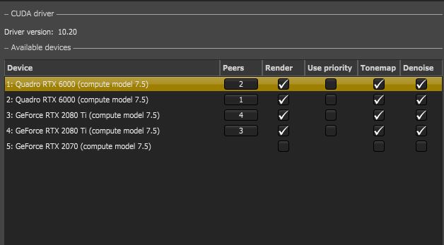

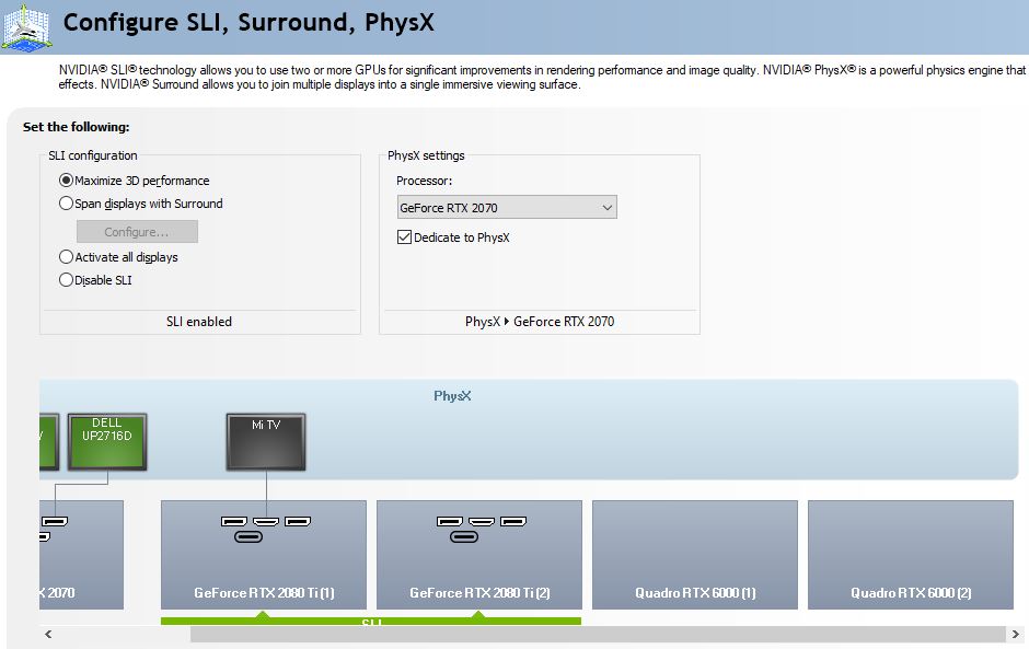

jimho
Posts: 271
amazingly a pair of 2080ti + a pair of quadro, it works!
though the quadro pair does not appear in the nvidia control panel
Supermicro 4028GR TR2|Intel xeon E5 2697 V3| windows 10| revit 2019 |Titan V+ Quadro GV100+RTX 2080 Ti

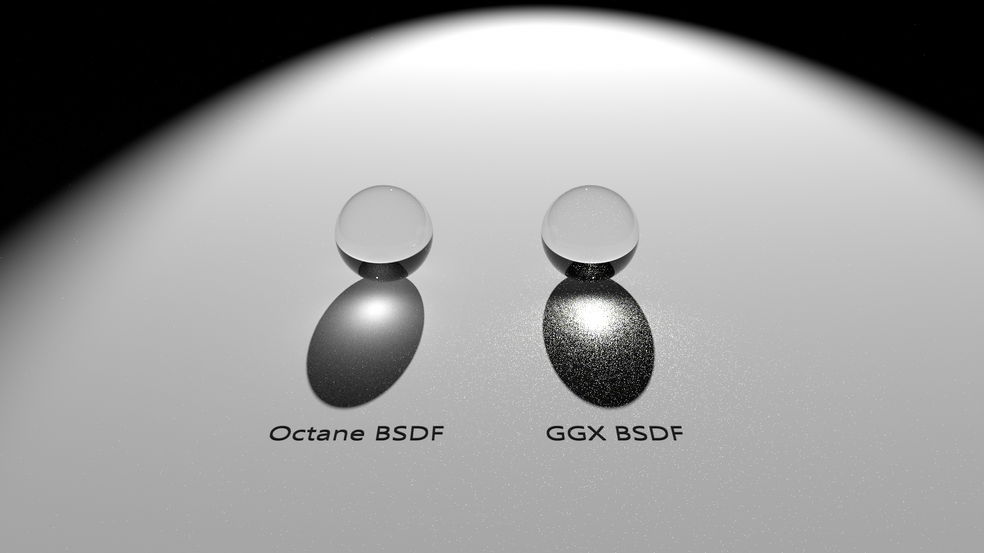

Hi there.
@aether_nox has encountered a Bug and gave me the scene for inspection:
This is not directly related to the latest version of Octane as it also occurs in other versions.
If you have a Octane Spot Light and shine it through a refractive object all works as expected. Caustics form nicely.
Unless you change the material BSDF to anything else then Octane. Then the caustics do not resolve nicely.
Please find attached the Orbx
Octane_Spotlight_Caustic_Bug.orbx
(1.82 MiB) Downloaded 273 times
