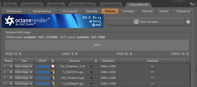

So... inevitable happened. It has crashed.
First I've loaded the scene that was quite heavy with textures (1.2 loaded and rendered it fine) and seen this funny chart:
vram chart
vram chart
Then, it crashed when loading next scene. (Can provide the crash dump)
