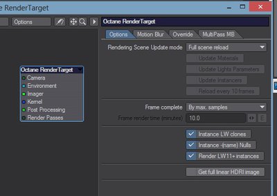

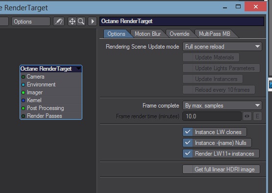

Juanjo, I have two problems:
-when using HDRLS button with HDR Light Studio everything looks exact in IPR. And when I render the env image in HDR Light Studio and use it in Octane environment, the IPR looks the same (except for huge resolution improvement of course). Then when I do F9 render, the LW preview during the render looks the same but when the actual rendered image appears in LW image viewer, it is notably darker :O I have all CS settings in LW as Linear. And without env. image that does not happen, the preview looks exactly the same as the final rendered image. Any idea why this happens? :)
-this is old problem but it is so serious that I now make the max. samples to use way over needed and then always do Abort+Cont because if I let the render go to the end, LW gets in not responding state often (the 99% problem), not always but too often.

atnreg wrote:Juanjo, I have two problems:
Other than these I have no problems with Octane :)
Antti
If all the LW color settings are disabled, perhaps the problem is that you have the "Get Full linear HDR image" option enbled in the render target. Check it.
I have tested several times your 99% problem here without luck, but I will try some things again tomorrow. Are you working with the last daily build?

juanjgon wrote: If all the LW color settings are disabled, perhaps the problem is that you have the "Get Full linear HDR image" option enbled in the render target. Check it.
YES! That was it, thanks! :mrgreen:
The manual only says "Enable to get the full HDRI no clipped and no tone mapped Octane frame buffer.". That I understand but what does it mean in practice? When should I use that feature?

atnreg wrote: The manual only says "Enable to get the full HDRI no clipped and no tone mapped Octane frame buffer.". That I understand but what does it mean in practice? When should I use that feature?
With this option enabled you get the full linear, not tone mapped, HDR image. This linear image can be useful to be used in post if you want to apply your own tone mapper, gamma or color corrections and so on.
-Juanjo
