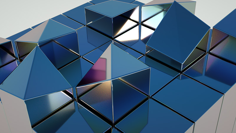

Octane rounded corners test
MODO 902 SP1 + Octane 3.0.4 | Windows 10 64bit, i7 4790K, 32GB | 2 x Asus Strix GeForce GTX970 4GB

Is it possible (better?) to change input value range from 0 -1 to 0 - 100%. Is that wouldn't be easier?
I /think/ the edge rounding value is actually a distance, not a percent. Perhaps 1 = 1m?
