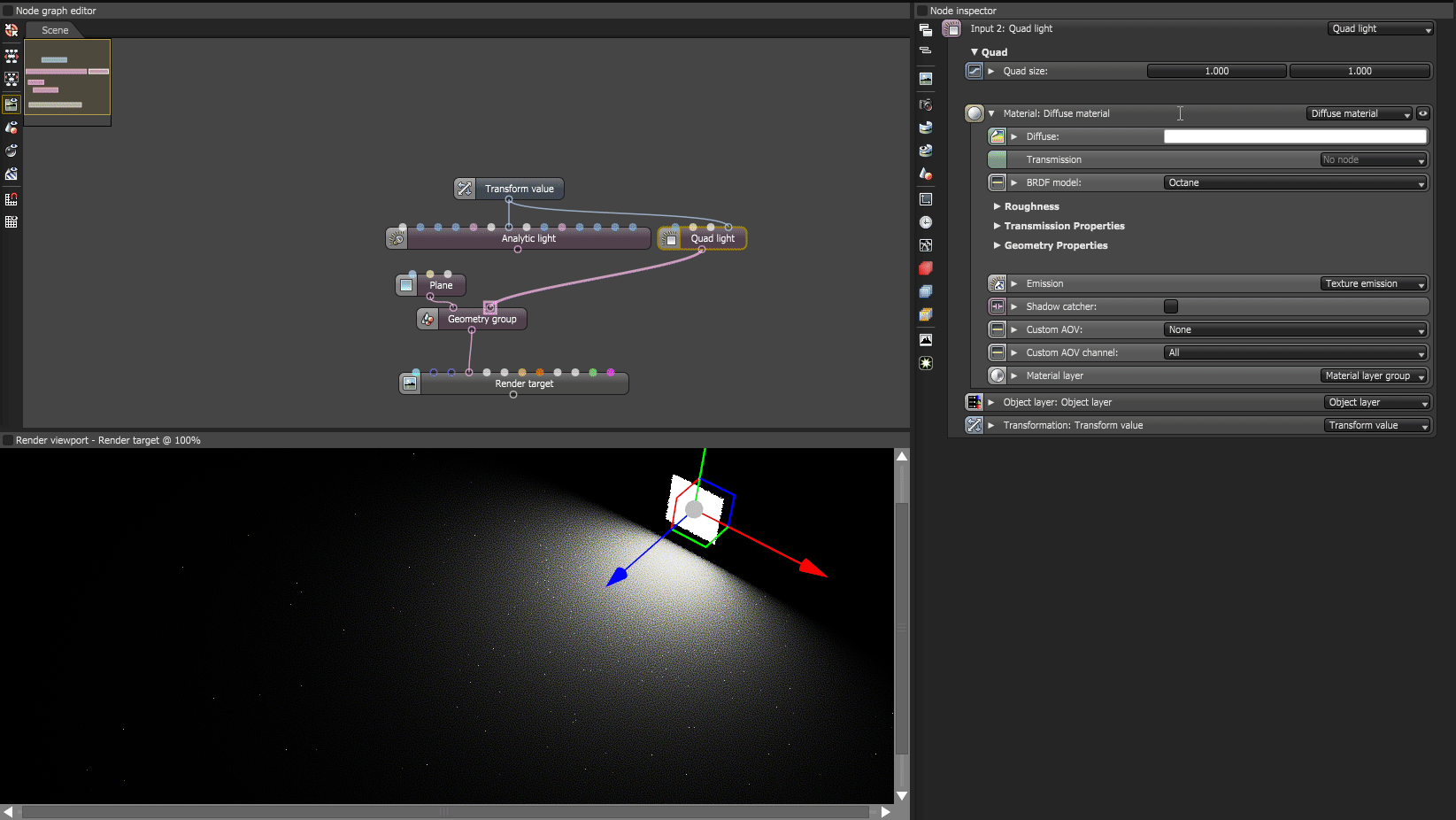

Following the Alpha 1 build, the material "diffuse" contribution is noticeably still present and causing unwanted sampling calculations.
Its default "diffuse color" would have to be a pure black, in the "hardcoded/concealed" underlying diffuse-emission material:
The same would apply to the quad light. Could this be expected in an upcoming build?
