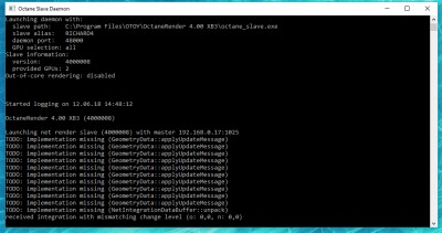

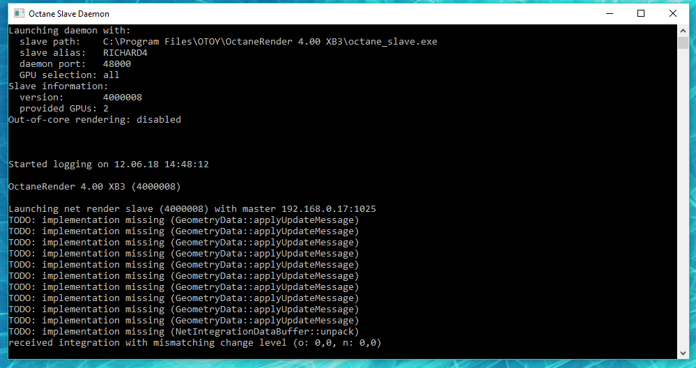

Guys ??? My comment has been ignored. Everything is working great for me except this NETWORK RENDERING. My two machines with Octane Daemons on them, no longer pick up the job. They just crash out. WHY ?
I am desperate to network render with this version. PLEASE HELP as above.
This is all I am getting when trying to network render...
TODO: implementation missing (GeometryData::applyUpdateMessage)
paride4331
Posts: 3912
richardyarlett wrote:Guys ??? My comment has been ignored. Everything is working great for me except this NETWORK RENDERING. My two machines with Octane Daemons on them, no longer pick up the job. They just crash out. WHY ?
Hi richardyarlett,
your comment was not ignored:
viewtopic.php?f=80&t=67834&start=10#p340122
network rendering is currently disabled for V4 SDK, it's still a work in progress.. XB is eXperimental build, not all features are supposed to be implemented
Regards
Paride

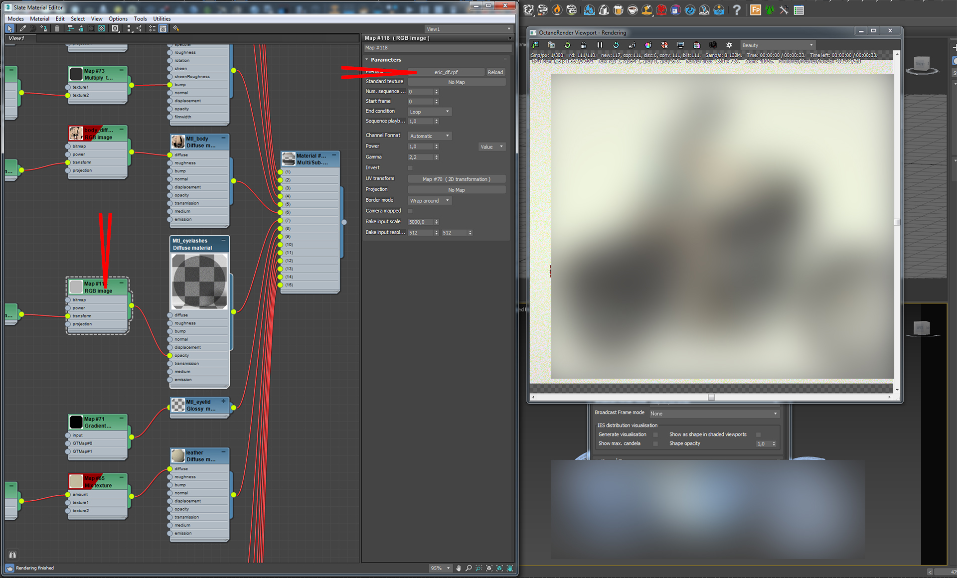

paulforgy wrote:Issues with this build:
1. The viewport gets stuck in loop where it renders about 8 samples and then starts over continuously. This seems to be a material issue. I rolled back to 3.08.1 - 5.11 and imported an object from v4 into a scene that works fine in the v3 viewport and the issue persists. If I assign another material, the viewport works just fine again.
2. Some animated objects and their shadows begin to disappear as they approach the camera.
3. I had an issue with objects having a random material color where the first frame of an animation had different colors than the rest of the frames. This same material renders fine in v3. The rest of the objects in the scene were consistent(not a lighting issue, etc.).
4. Denoising doesn't work with stereo cubemaps. The image denoises okay, but the denoised areas aren't consistent between each eye, and therefore the perceived depth of those pixels is incongrous and clearly out of place. Not sure if static noise setting would fix this issue.
Hi paulforgy,
1 2 3 could you share scenes and screenshots with your issues please? (in p.m. if you want).
4 static noise would solve your issue.
Regards
Paride
richardyarlett
Posts: 197
Joined: Thu Apr 09, 2015 8:48 pm
Hi Paride
Oh ok, I did not see that network rendering is disabled. That really limits what I can do with this right now. Do you know when they will do an updated build with network rendering ?
Hi paulforgy,
Regards
Paride
I'll give static noise a try, thanks.
PM sent regarding 1-3.
paride4331
Posts: 3912
richardyarlett wrote:Hi Paride
Hi richardyarlett,
I don't know; It doesn't depend on 3dsMax developers, but SDK developers.
No Octane plugin or SA is provided with network render at this time.
Regards
Paride

paulforgy wrote:
Hi paulforgy,
Regards
Paride
Hi paulforgy,
I tested your scene,
1 sample issue depends on .rpf file into opacity slot; .rpf is not compatible using Octane. Deleting it, sample run as well.
2 helmet issue > group biker with helmet
3 random color chenge 1 frame issue > try to make a new bushes material to assign your scene.
Regards
