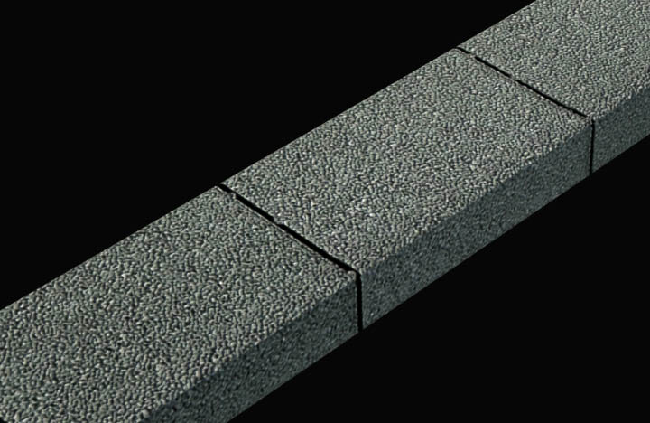

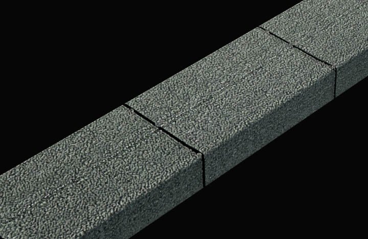

aufwind
Posts: 122
Joined: Sun Mar 31, 2013 4:47 pm
thanks for the update.
It seems that bump maps behave differently in 3.08 compared to 3.07
3.07
3.07
3.08
3.08
bump.orbx
(4.58 MiB) Downloaded 317 times
Win7 | Gigabyte G1.Sniper 3 | I7 3770K | 2x Titan (Kepler) | 1x Titan X (Pascal)
