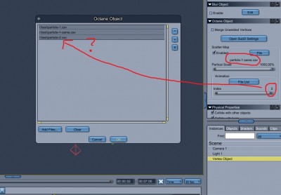

Me again,
just saw that animation mode works, but not as expected. See image. Last file is "particle-2.csv," but that's not the file, which is selected...
Best wishes,
Thomas
Scatter animation mode

Sighman
Posts: 1112
Joined: Thu Jan 19, 2012 9:11 am
Location: Calgary, AB
tschwenke wrote:Hi,
No, I mean replicators in general. Just add an replicator to your scene. You don't have to replicate anything. Octane Render will crash.
Could you open the CSV? Did it work for you?
Best wishes,
Thomas
I still need to investigate the crashes but I was able to load the CSV. It just comes in really big so you have to zoom out the camera a long way before you can find it. For a sphere, try setting the primitive size to 1 inch (0.08 ft). Note that the render does not restart if you change the primitive size so use the rebuild scene button on the ORVP.
Win8/64, I7-4770K (3.5Ghz) 24GB, GTX-980ti (6GB) / GTX-TITAN (6GB)
