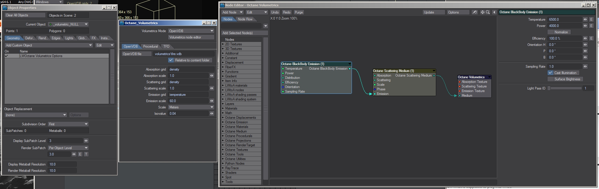

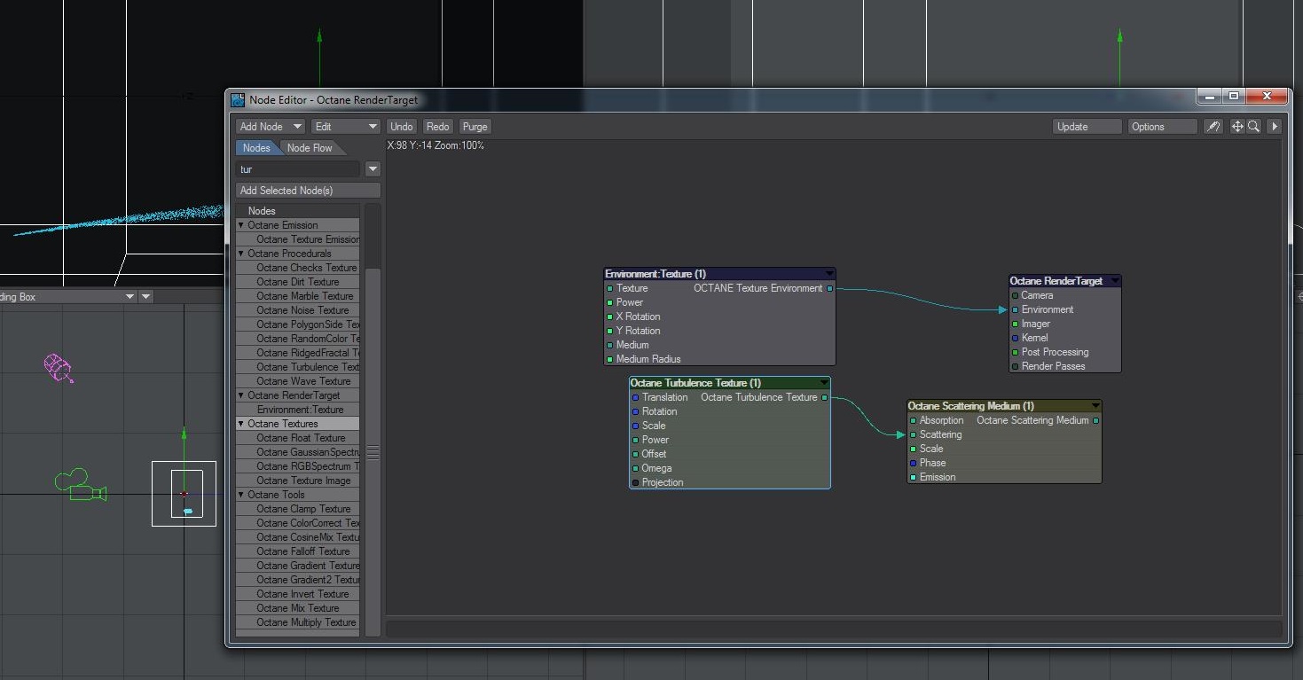

Hello, Juan I need your help again. (You gave great help with Houdini
, and I have Lightwave w/TFD 1401 now also...)
I am having trouble finding the Octane Volumetrics node for TFD setup. Without going into it, I'm new to Lightwave and I feel like I am hooking up a home theater system and I don't know what is supposed to plug into what.
Can you provide a screenshot of a sample TFD node layout? Thanks!
This is mine, I know it's wrong.

You are definitely going to want to plug some other crap into your Render Target.. like ThinLens Camera, Imager (make sure you are set to full linear workspace in options -- type o and select CS tab, change everything to linear), and most important, Kernel.

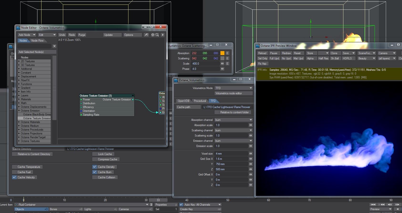

Q - Where is the Octane_Volumetrics Node?
A - It's no where! But, hit "p" on the keyboard and 'Object Properties' will magically appear, then under 'Geometry' click the dropdown which allows you to add custom objects, and add (1) Fluid Container, and (2) Octane Volumetrics
Then, in that same Geometry Tab, doubleclick on "LWOctane Volumetrics" Options (which you added when you add 'Octane_Volumetrics), this brings up a new Octane_Volumetrics Window. Click on TFD, set your Cache path, which should match the Cache path set in the Turbulence FD 'Containers' option (says "Cache Directory"), and you can mod the general properties of the density and temp in the Octane_Volumetrics Window. Then, in this same Octane_Volumetrics Window, there is an option called 'Volumetrics Node Editor'. Click on this to open up a node editor which will have 'Octane Volumetrics', which has the option to set scatter, absorption, and black body (MEDIUM > OCTANE SCATTERING MEDIUM > OCTANE BLACKBODY EMISSION.) If you click on these then you set the parameters like in the standalone.

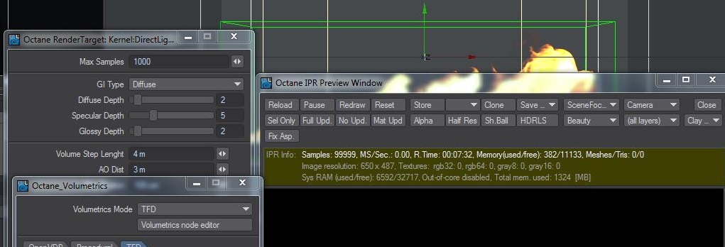

(1) I ran flamethrower example in TFD and was only able to achieve IPR lighting using Texture Emission, whereas BlackBody never displayed anything no matter what numbers I threw in to the emission.
In this case the TFD container did not have a cache 'Temperature', but rather a 'Burn', which when selected produced the lit image in Texture Emission. Is Black Body not able produce lighting for an image unless it has a "Temperature" unit cache?
(2) It looked like my Kernel was set to 1,000 max samples (I believe is default), but the IPR appears to be rendering past 1,000, up to 99,999. Might I need to do something with another setting?

I think that black body works only with temperature cache as Juanjo said somewhere, but team is working on a gradients for container data so you can color it as you wish meaning you could even use textured emission with a gradient to color it similar to black body or anything else.
And there was some talk that you might need to scale container values enormously for black body do render correctly.
