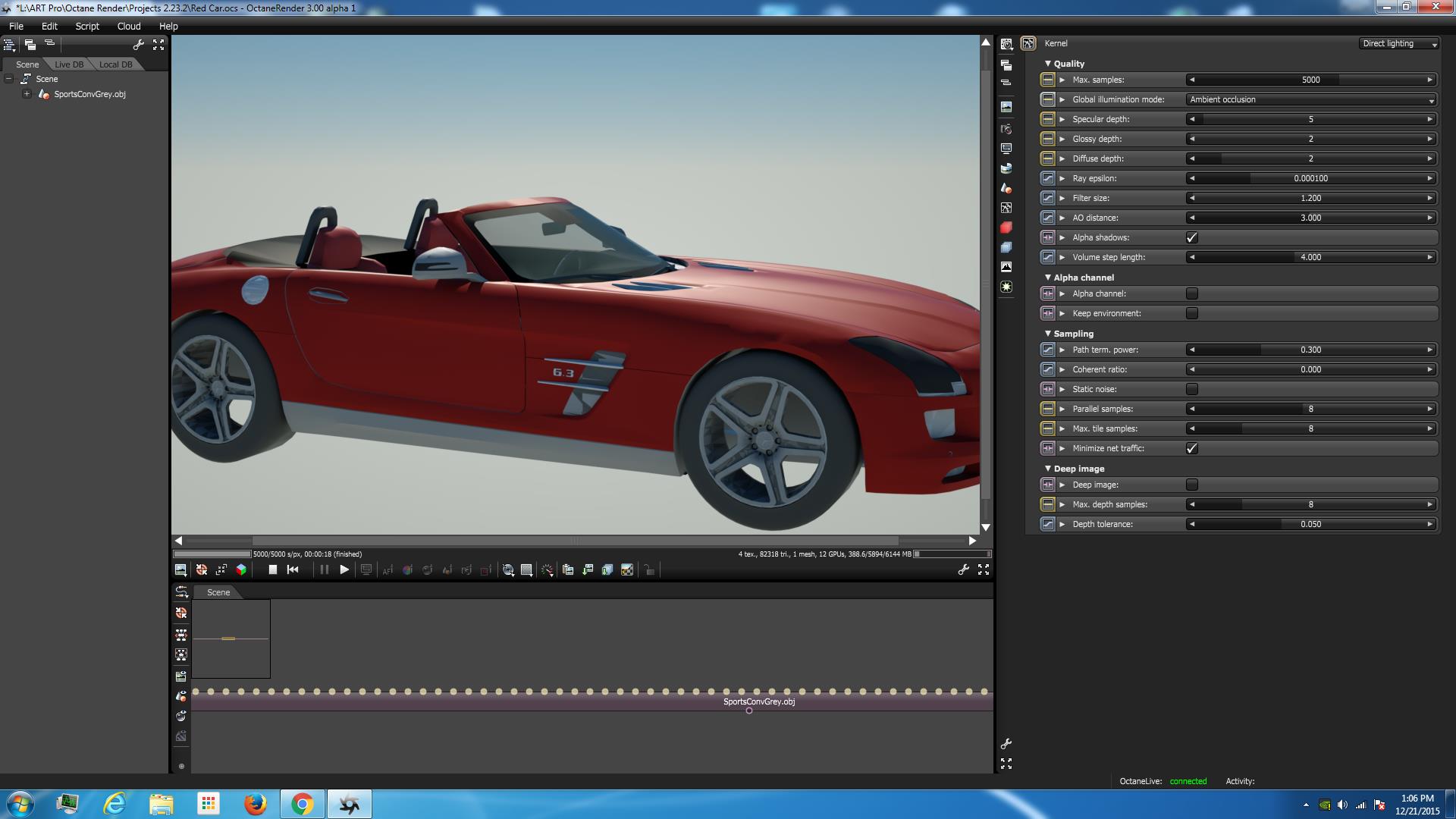

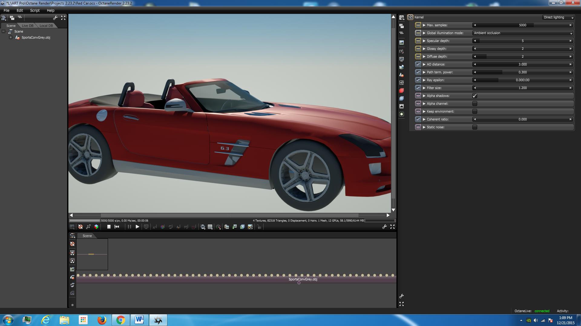

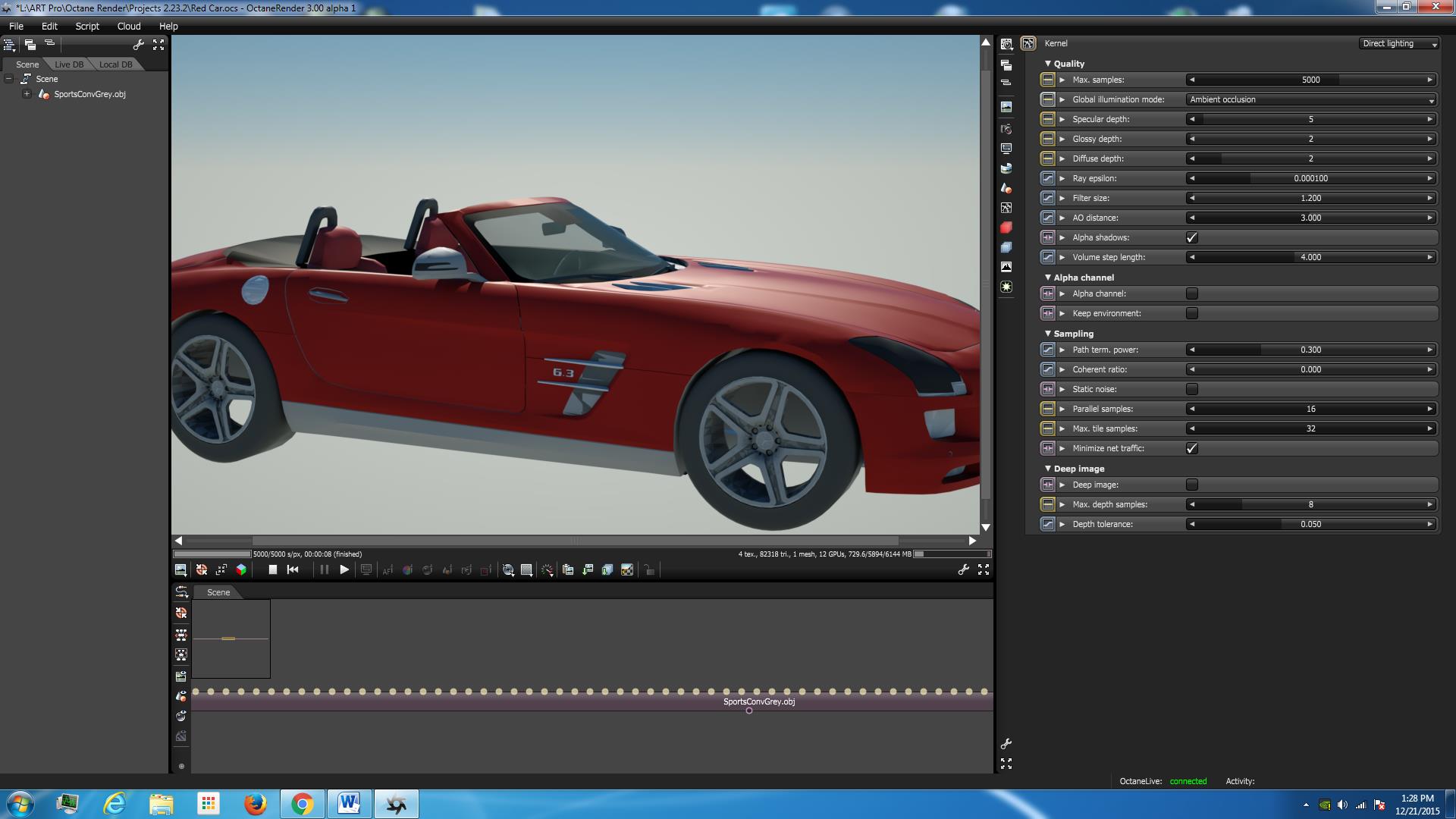

Maybe a separate phenomenon, but maybe related to my above post about laggy viewport UI. Please note photos were with Alpha 1, but same occurs when using Alpha 2.
Same scene:
(1) V2.23.2 at default loads at ~58 memory usage
(2) V3 at default loads at ~388 memory usage
(3) V3 loads at ~729 memory usage if Max tile and parallel samples and are set to max (used to match render speed of V2.23.2)
What might be going on here... :?:

Reduce parallel samples to 1 to save vram memory
