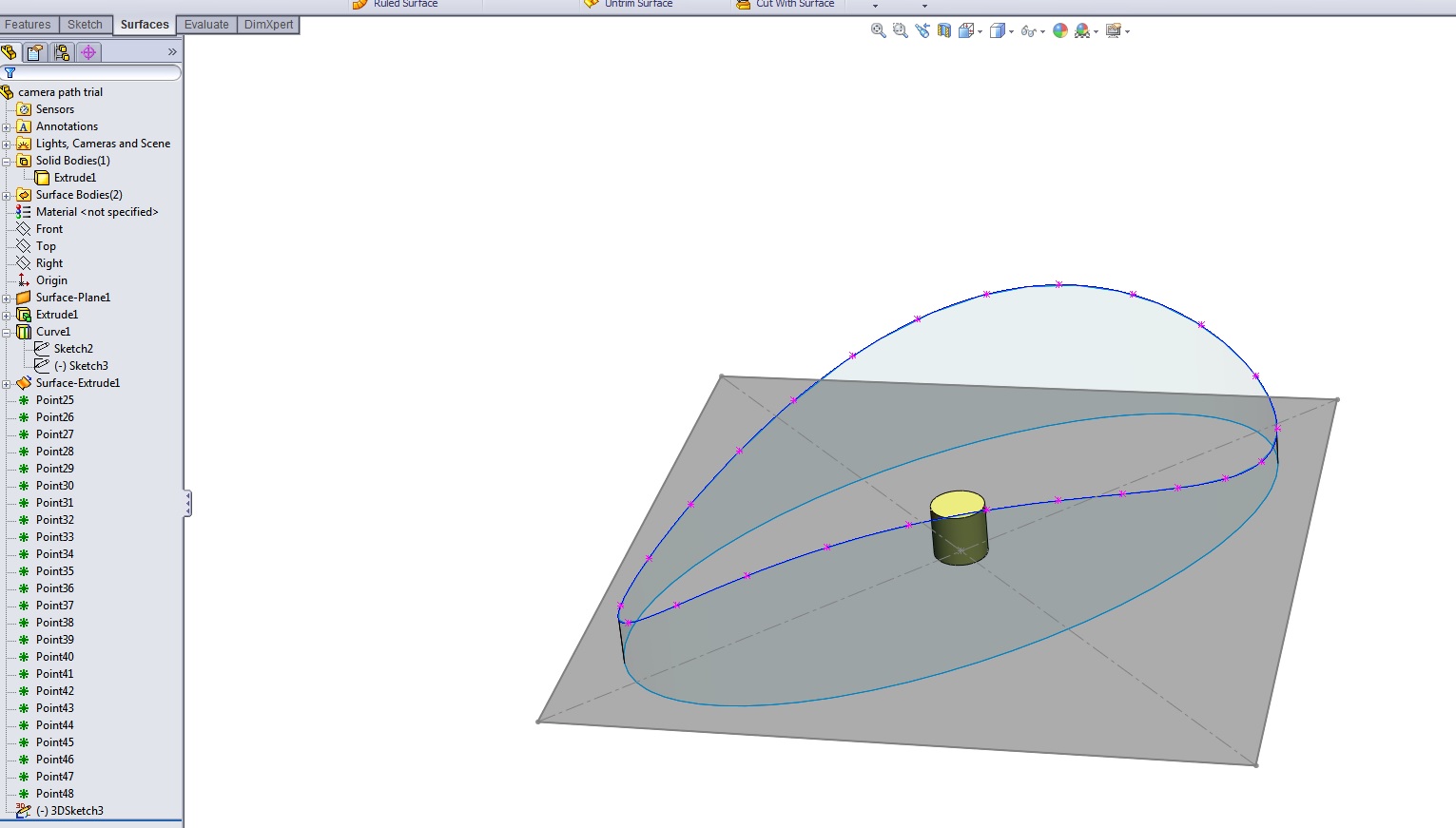

I tried a wee experiment in Solidworks. The path here is a projected one arising from an ellipse and a parabola. I then divided the path equally into 24 (edit actually I see one is accidentally repeated) and used a macro to save out the co-ords to a txt file.
This was quite quick and easy to do. Virtually any imaginable geometry could be used as a basis for obtaining the camera position for each frame. All it needs is to be read into the script.
You are right though, how much functionality is enough considering cg apps do this natively?
Still at least if someone wanted to, they could do this type of thing, although you are 'not supposed to'. Just don't tell Uncle Roeland about it :)
