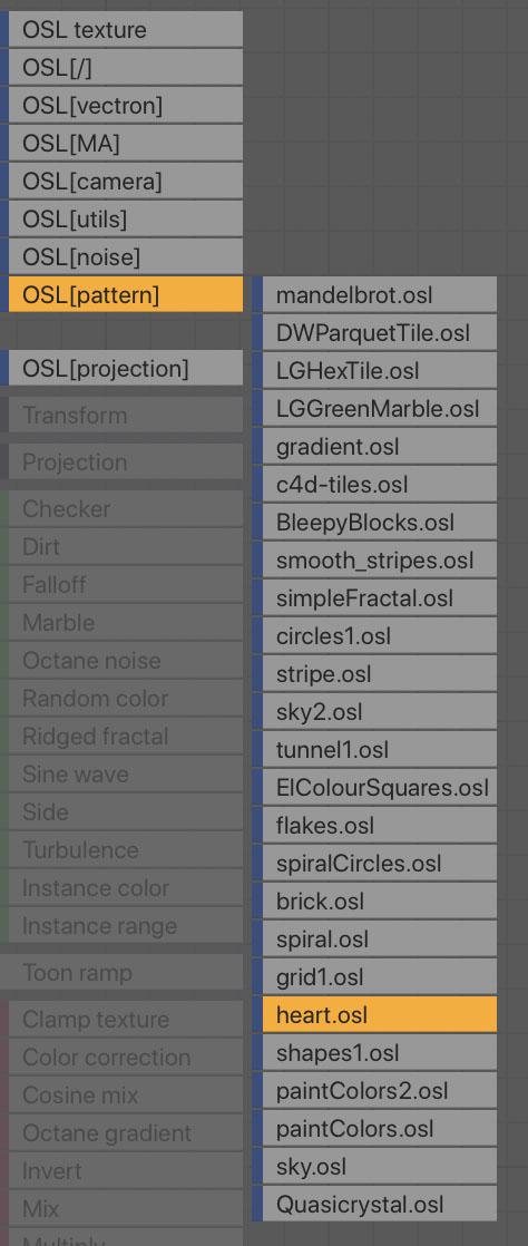

Am I doing things wrong, or C4D PR3 plugin still not supporting OSL?
Thanks,
Eduard
Posts: 10549
Hi Eduard,
yes correct, OSL nodes are giving stability issues for now, so better to keep the OSL conversion option disabled, at the moment, in c4doctane Settings/C4D Shaders panel, to be able to use both c4d Gradient and Noise converted into texture, instead of OSL.
The issue will be fixed in the next release.
ciao Beppe

Beppe I mostly interested in using external OSL shaders, from which we've done for Maya lookdev, but seems like they are not reading at all.
really hope soon they will start supporting.

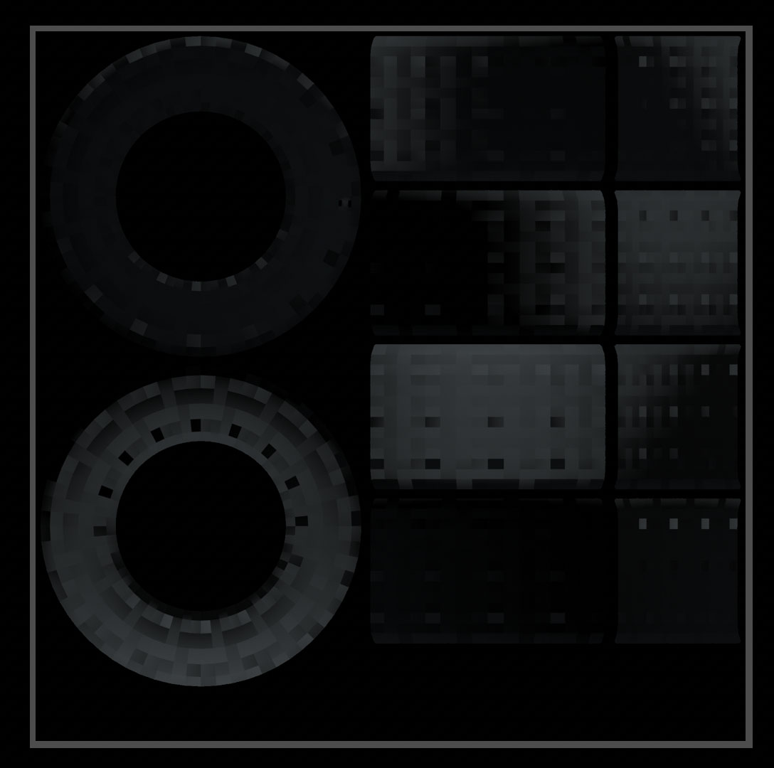

kinedix wrote:
bepeg4d wrote:
@kinedix: please use Octane materials with Octane node only inside, when working with Baking Camera.
ciao Beppe
Yes this what I am using, Octane Material nothing else. will try to attach the scene.
The attachment octane material.jpg is no longer available
PR3 and it still exact the same result( recreated scene from scratch, didn't helped. Light baking still not working properly.
Eduard
