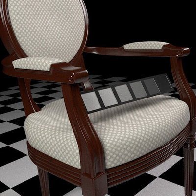

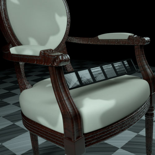

I think I need some help with Octane in understanding it.
below is a render of a modo scene, beside it is the octane scene.
I created an override for the 2 area lights that are in the scene.
I have one UV map on the chair and one for the floor, they are two separate objects.
On the octane scene the bump map on the wood frame has gone haywire. I added an override to the front arm supports and noticed the power of the greyscale image for the bump was at 1.0 I reduced it to .1 to get the bump under control. I would of thought the plugin would read the bump value from modo. Is this not the case?
The fabric on the chair is a pattern that gets repeated 65 times in the horizontal and vertical. In the Octane scene the pattern is not repeated. If I add an override to the material I see no way to repeat the pattern.
Why is the plugin not getting the values from modo for the pattern.
The wood texture on the legs and vertical arms does not go the right way. In modo it's rotated 90 degrees which Octane is ignoring and I have been unable to get it to rotate in octane.
On the floor I added a material override so I could use the checker texture. It is always giving me this weird effect on the texture, also how do you change the color of the checks?
My greyscale checker in the modo scene is correct but in the octane scene it's messed up.
Now I'm pretty sure that this is all my doing, but it's got me stumped. I just can't seem to get to look right.
Anyone know what I doing wrong.
At this stage the bump map power from Modo is not converted to Octane - however this would be a reasonably easy enhancement to make. How are you setting the strength of the bump map in Modo? Low Value/High Value?
The plugin should pick this up automatically - however I just checked, and there seems to be an issue with some projections that has been introduced with the latest version, which I will investigate (and hopefully fix) today.
See above.
Yes - this is due to the Octane Checks node not working if the source geometry is at the origin on the scene. Raise it a tiny amount in the Y axis to fix.
