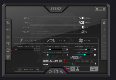

If you don't have access to extra parts for testing, you can also try using MSI afterburner to lower the power limit on both cards. Set it to about 70-80%. You lose very little performance in Octane (1-3%). I've done this in the past to keep things cooler and more power efficient too.Anim8me2 wrote:I am guessing that despite my having a PSU rated for 1600w I am not getting full output. Would an additional PSU just for the GFX card be a common solution?

Which MSI setting are you referring to? Under "Voltage" or "Fan - Power Limit"?
