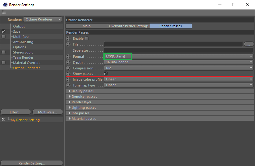

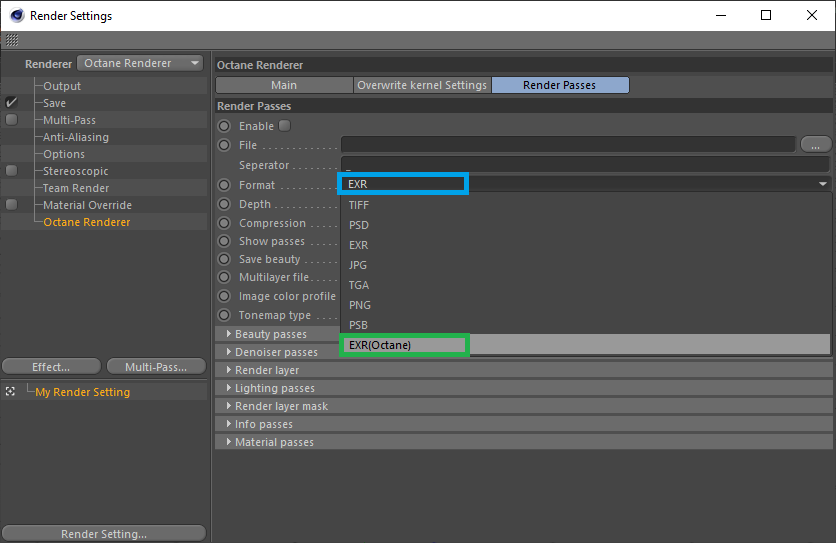

I am arguing that the EXR saving dialog in the Octane Multipass save settings compresses the files weaker then if I do the same in C4D.
If you go a page back, you can see my initial post (also with unticked multilayer file box)
viewtopic.php?f=85&t=70622&start=10#p356857
Ahmet answered that with the new EXR (Octane) option in the list (see attached image) there is proper compression. But when choosing the EXR (Octane) option, you are no longer able to save non multilayered files.
So basically I am asking if its possible to have single non layered EXR files from the Octane Multipass section that are equally (small) compressed then what I get via the C4D save dialog.
