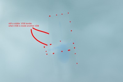

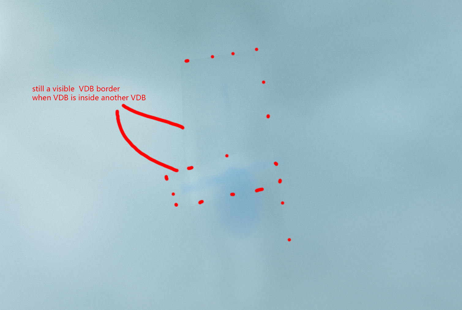

Can you send me an orbx with these volumes in that setup please?coilbook wrote:I just want to say that there is still a problem with overlapping VDBs. In our case one small vdb is inside vdb cloud. The same step length but you can clearly see vbd border of a blue vdb helicopter. Hopefully you can look into it.
