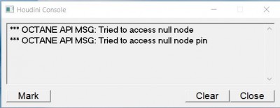

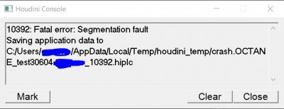

I installed this test build and getting this error:
Do you know why?
Just testing a simple sphere and trying to open the IPR Window and then it crashes.
Edit: Reinstalled the "test 2" release for H16 Indie and that seems to be working fine. Just got this null error.

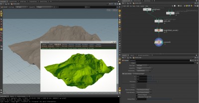

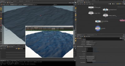

Hello, please tell us when Ocean, Fur and Terrain will become usable with Octane in Houdini 16?
We have been waiting a while for these hugely important tools.
Thank you.
juanjgon
Posts: 8867
Location: Spain
You can use the H16 hair system right now, as you can see on this post:
viewtopic.php?f=101&t=60507
About the new Terrain tools, should be possible use these objects if you convert them to polygonal meshes, as you can see in the attached image. The terrain nodes are Mantra procedural objects, so the only way to use them with Octane is converting the procedural to a mesh object. The shading must be done using the Octane materials, the Mantra materials can't be used with Octane, including all the Terrain shading stuff.
Your best chance to render the Ocean objects is to try to export the ocean elevation data as a sequence of texture maps that later could be used with the Octane displacement maps feature, applied over a flat plane (you have a export to texture feature in the Ocean SOP node). Like happens with the Terrain tools, the shading must be done using the Octane materials. Another faster possibility is to convert the Ocean SOP (used also to preview the mesh in the viewports) to a mesh object, that can be rendered by Octane, as you can see also in the attached image.
