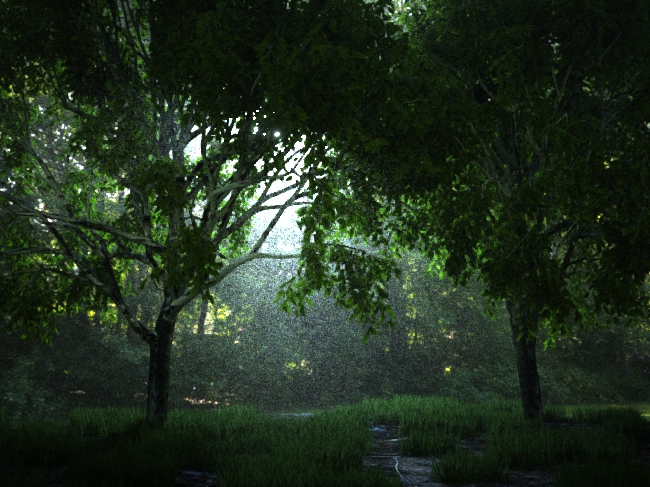

Here's my quick test with Juanjos scene. I dropped the density to 0.02. Tree leaves and grass have slight transmission setup, so that the light passes trough. On the ground I used displacement map to generate details, instanced some grass to it, from where the light can bounce like crazy and illuminate all the details.. Background is LDR image (as opposed to HDR), but it gives a nice tone to the scene.. I dropped the light power to just 5000. Imager node is set to "linear"..
These things needs a lot of fiddling. Give LW/Octane another three months. This is very different to what it is with LW native renderer. It is absolutely essential to think how the light / cameras works in the real world. Same tricks what professional photgraphers use, do apply. For example adding a reflective surface/additional light source behind a camera to shed more light to the foreground - is not cheating. It's pro.
Edit.
..and of course I used a PMC kernel! Also postProcess node, added some bloom effect..
