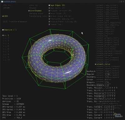

Adaptive openSubdiv works well in Maya or Max viewport,
but yes in Octane we are not there yet, for example here is a Torus in OpenSudiv GLviewer :
you can see even at lvl 1 the torus is smooth (and screen space tesselation is off),
in Octane the same torus is never tesselated whatever the lvl is.
Aren't we supposed to use an OSD tesselator with the weighted bi-cubic patches instead of using the coarse vertex ?
Also OpenSubdiv in Octane is a CPU preprocess and is a bit slow (V2 compared to some other renderers OSD),
so I guess it only use a primvarRefiner Far API layer and no OSD layer?
Why don't use stencil table and a OSD api layer evaluator with Cuda backend ? sounds to be way more faster.
Sorry if what I say doesn't make any sens, I tried to read carefully the Opensubdiv API documentation, and I understand its primary purpose is for interactive display so may be hard to use for a renderer.
