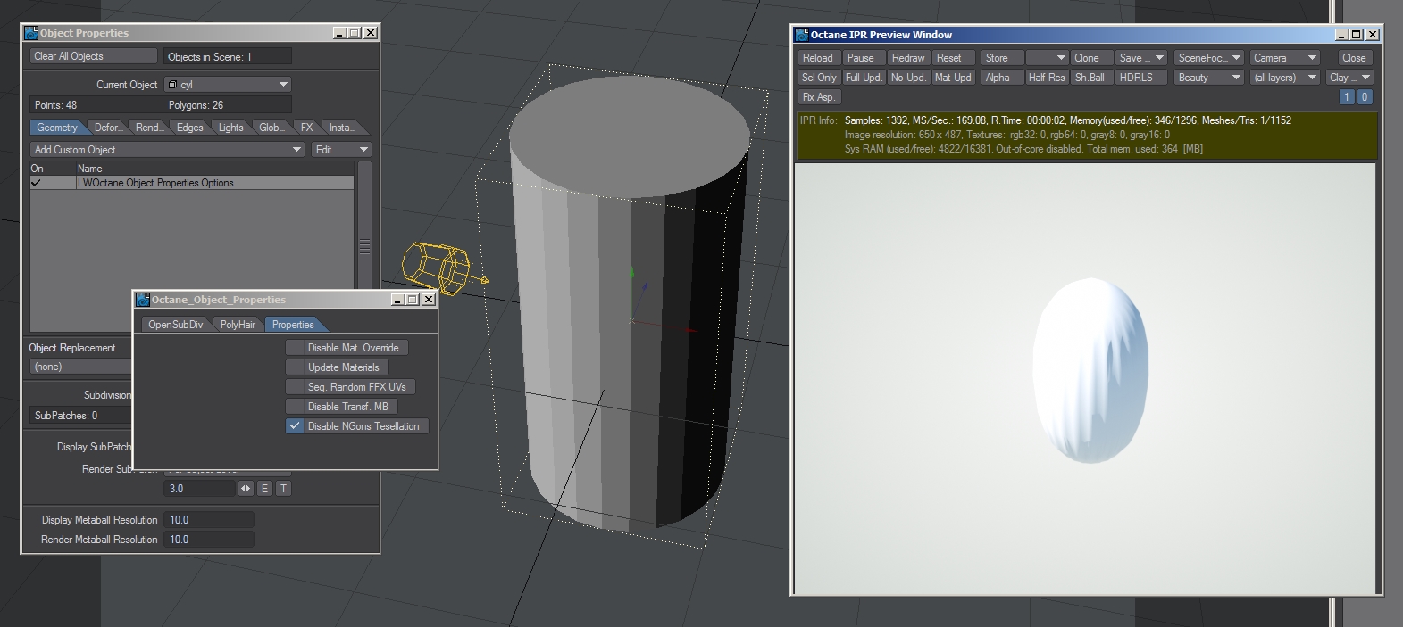

FrankPooleFloating wrote: NGons support is really nice, and this will definitely speed up workflow.. however, just for the hell of it, I made a cylinder and turned on Octane OpenSubDiv, and the results were strange. Not that I would normally subd an ngons mesh, but it appears to subdivide the bottom half of the cylinder and not the top.. try this. Weird. :?
To fix this problem I've added a new parameter to the Octane custom object plugin to disable the NGons tessellation functions. With this option enabled you should get the same behavior with the OpenSubD surfaces that you had before this release.
