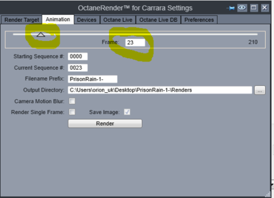

SciFiFunk wrote:Some more notes on Animation.
This is what I do, animation. Carrara is a great all round tool, with a pretty decent animation toolkit you can use without leaving the program. So these features would greatly help an animator.
1. We need to know which frame we are on when animating out a sequence.
2. Time left to complete render would help us to plan our work.
3. When animating with the camera a dynamic render whilst moving the Pan Icon would mean I could have the viewport open whilst choosing a camera position/movement. atm it only updates after I let go of the icon - the Carrara 3dview updates as you move.
Less of a priority, but important.
4. I'm having to keep half an eye on OC guru as I can't see a temperature read out on the cards. This becomes important on long rendering sessions.
Thanks.
Hope this feedback is useful. Thanks for your replies.

Ah, this is not so easy. I need to test this again but from what I remember, Carrara does not generate an event when you switch the 3DView camera, so I can't track it. What I might be able to do is list the cameras in the viewport and allow you to change it there. It is still going to slow down your workflow a bit but not as much as switching to the Render Room and back.SciFiFunk wrote: The viewport is tracking the render camera fine from my early experiments. What would really help my scene development is that when I change the 3DView camera, the viewport also updates. With DAZ it will work some of the time, other times I rebuild and it updates. With Carrara I cannot get an update this way.
The reason this is a problem for me is that I specialize in large scenes. Often Carrara it's self is unresponsive due to the scene size, so I set up a lot of cameras covering the set, then switch between them. atm I will have to go in and out of the Render room.
Win8/64, I7-4770K (3.5Ghz) 24GB, GTX-980ti (6GB) / GTX-TITAN (6GB)
As Orion pointed out, this is shown on the animation tab.SciFiFunk wrote: 1. We need to know which frame we are on when animating out a sequence.
This would be in 'Microsoft seconds' as animation is based on max samples and not time. I would have to base the estimated time to complete on how long the previous frames were taking.SciFiFunk wrote: 2. Time left to complete render would help us to plan our work.
I wish. I have tried. It's a threading issue. Carrara does not release the UI thread until you release the button.SciFiFunk wrote: 3. When animating with the camera a dynamic render whilst moving the Pan Icon would mean I could have the viewport open whilst choosing a camera position/movement. atm it only updates after I let go of the icon - the Carrara 3dview updates as you move.
Not sure what you expect for this one. Do you want a temperature readout on the animation tab?SciFiFunk wrote: 4. I'm having to keep half an eye on OC guru as I can't see a temperature read out on the cards. This becomes important on long rendering sessions.
Thanks for your responses.
1. (current frame). I missed that! (And it was right in front of me. ha ha, Oh well.) An instant fix then
2. (completion time). Estimated completion time would be excellent even if a little wrong. We are used to this in Carrara atm. Thanks.
3. (GUI update). That's ok. At least you tried. What I am doing to compensate is to keep the testing in 800x450 so on a 1920x1080 screen the Octane viewport is not too much in the way of the 3d View screen.
4. (Temperature). A temp readout on the viewport please. This is what the DAZ interface gives and I'm glancing up at it from time to time. VERY useful in spotting a faulty card as I found out. Also good for long render runs. Worst feeling to burn out a card unnecessarily.
5. (Camera selection). Yes please. A selection list in the viewport would be a great compromise, as you say that keeps the action all within the same screen.
