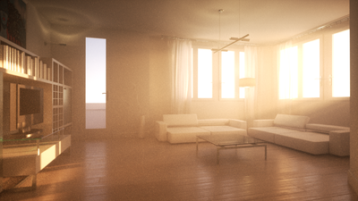

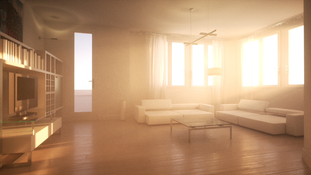

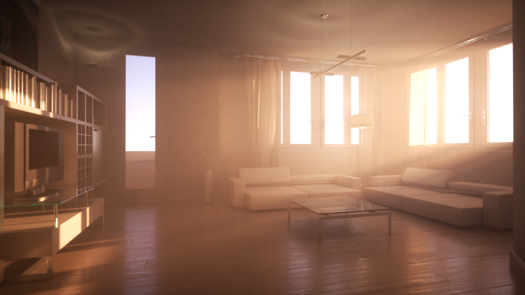

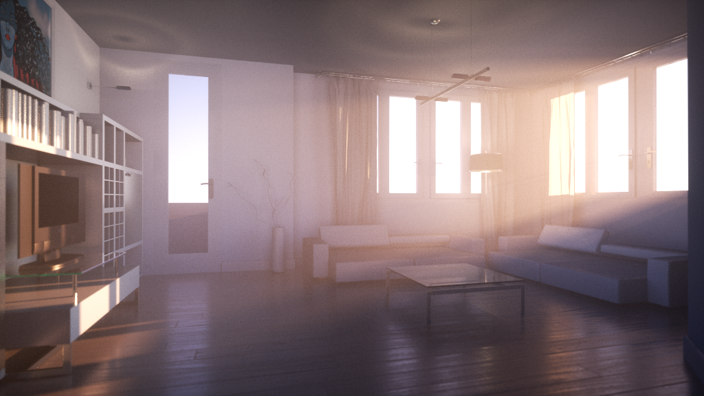

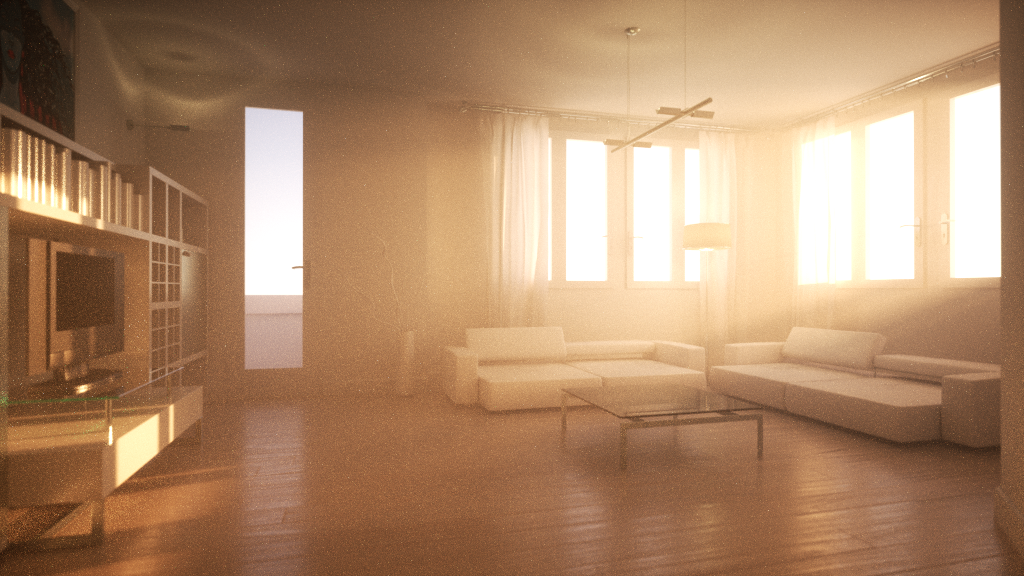

manalokos wrote:yes, just make a sphere with inverted normals with a placement node with camera coordinates, with the same scattering material of the volume bounding box.
the inverted sphere is a big trick, thanks :)
a little quick test with dl-ao, dl-diffuse, pt and pmc at 16000 samples for about 16', 25', 28', 35':
ciao beppe
