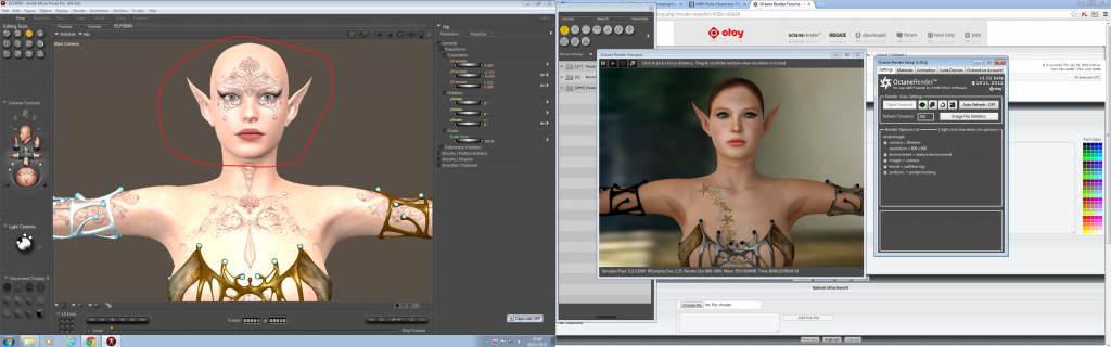

hi i having issue with a skin . on Octiane i have closed down resaved and still does not apply the skin
to octaine any ideas i supply the Original files if it helps.
sure its a bug!
Hi. What do you mean by "apply to skin"? Are you loading a previously saved template, or reconverting from Poser, or pasting a material to all skin materials? Could you describe your exact workflow pls, and I will resolve the issue.

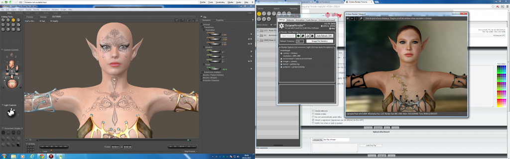

Yes sorry please forgive me its 6:39 AM here in the UK and I'm not quite awake yet
I can supply you with the original files if this helps from the vendor.
Basically I have tried to apply the face skin.
But it doesn't seem to apply to the mesh on octane even though you can still see it in Poser
You will see the character has various Tats. It quite happily renders as you can see in poser when I try to take the character into octane it neglects to take the updates from the character stored within poser if this makes sense.
I have rebooted.
I'm using Poser pro 2012 version 9.03.23027
Windows 7 64 bit with 24 gig ram
With a GTX 450s one gig ram
Sorry and very new to this forum are what you mean by a template exactly?

I've fixed the problem I believe it's down to user error and me not understanding that you cant stack multiple skins on top of each other it obviously only takes the first skin to render.
Sorry to waste your time but it down to user error
