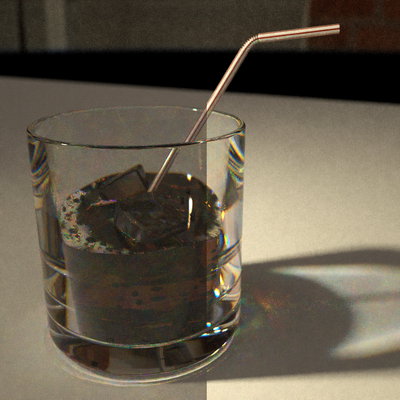

First of all I know that this built is not "multi-gpu" ready, yet I wanted to test both gpus, my old 470 and my new 570 at the same time (I had a low power ups and I couldn't get both running at the same time till today). The thing is I know there are some issues with running on multi, but the funny thing is the difference on exposure or each one. I haven't tried the same shot with either one to see if it's consistent (I'll try later). Is this "expected"?

I got sometimes (not for every scene) a difference in treatment between right and left side of the rendered image, but it was not a difference of exposure : rather one updated faster than the other : right side more grainy if I remember well, and the difference is no more visible after a certain amount of samples per pixel. The problem had been fixed in previous versions with Cuda 3.0, but appears again with 2.47, so I think that it is a problem of multi GPU support in this version.

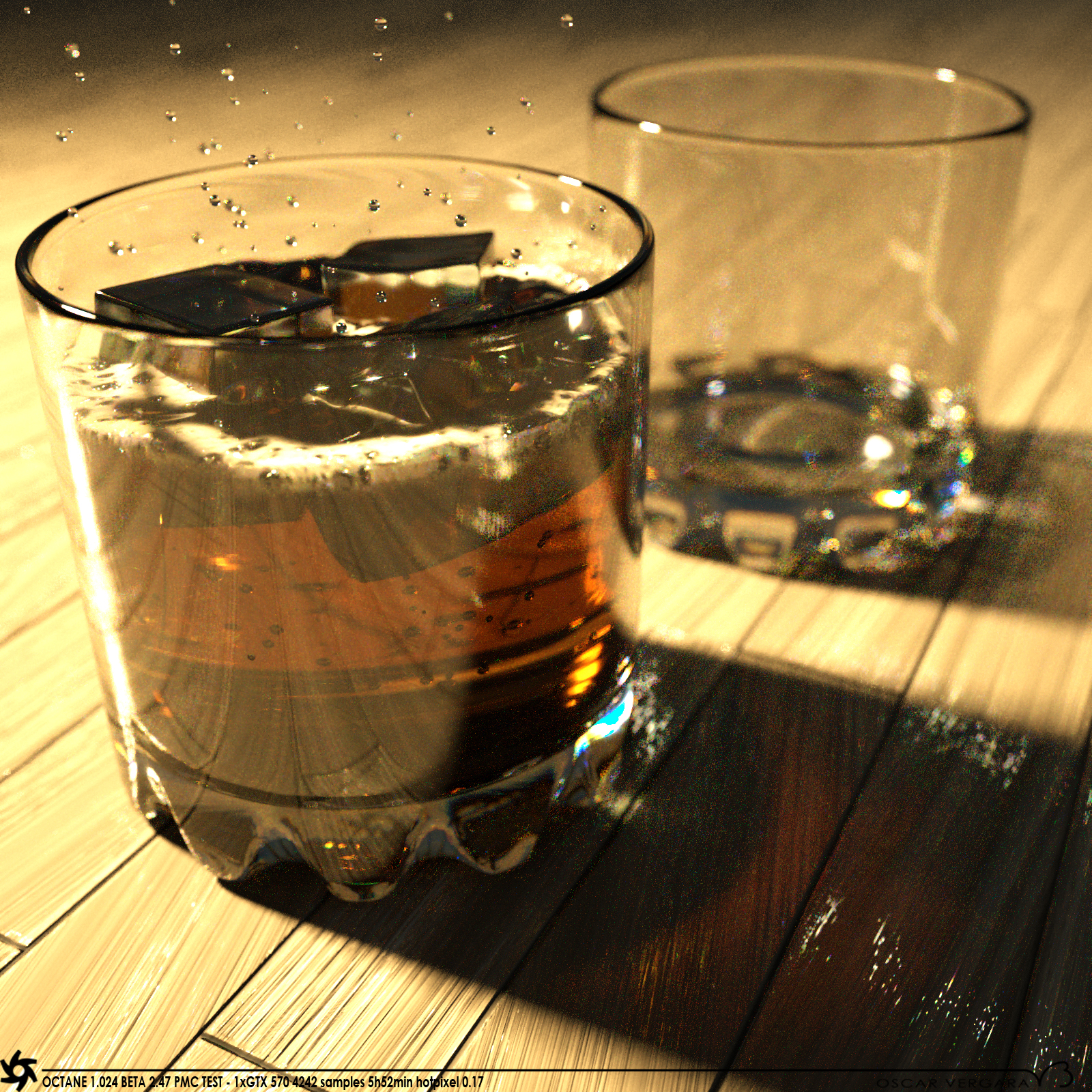

in my little spare time I've done some tweaks to the model and materials, no straw this time, specs on the render. Caustics are fun! I hope to have some time by the end of the week and I'll post wips and upload the coke and foam material to the LDB
