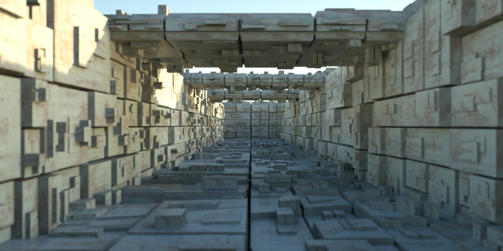

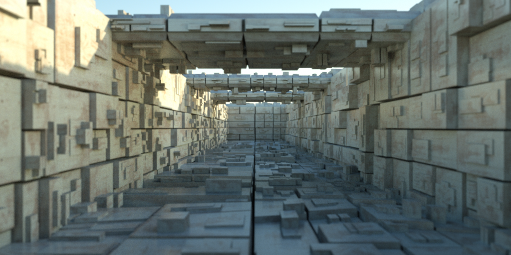

Ok, I had a look and the problem is that in 1.01 and 1.02 the glossy material in the (old) benchmark scene gets loaded with an IOR of 1.3 (which is wrong), while 1.0, 1.03, 1.04 and 1.05 load the material with an IOR of 0 (which is correct). Loading it with an IOR 1.3 reduce the specularity a lot, which means that less bounces will be traced and it renders faster. Obviously the rendered image looks fairly different:
IOR of 0.0:
IOR of 1.3:
To see how things actually changed over the last releases I ran the benchmark through all 6 versions with both IORs and these are the results on my GTX 690 (using both GPUs):
Code: Select all
version  |  IOR 0.0  |  IOR 1.3
 1.00    |   22.7    |   27.2
 1.01    |   21.8    |   26.3
 1.02    |   22.7    |   27.2
 1.03    |   22.7    |   27.2
 1.04    |   22.3    |   26.8
 1.05    |   22.3    |   26.8
You can see that beside a little speed drop between 1.03 and 1.04 nothing really happened. We will have a look into that drop, but out of the top of my head there haven't really been any changes that directly affect render speed in the benchmark scene.
Conclusion: Always check that your benchmark result is the same, when you compare those. And if you want to speed up stuff, try to tweak your scene, often you can improve things a lot this way.
