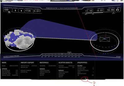

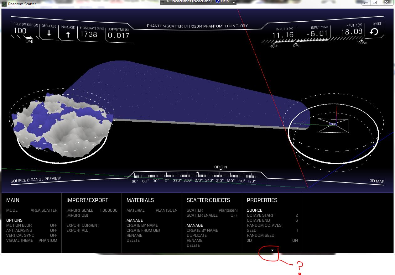

How can I open the other properties (like area scale).. whicha are under the arrow I guess.
I cannot open the arrow.. Maybe have I missed something int he manual about that?
greetz,
EDited:
oops, sorry... I found it...just scroll it... duh :roll:

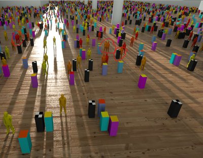

I wanted to split up the csv ile in random csv files to make a mixture of objects without overlap.
I can do that by opening the one csv created by PS and then split the lines of the file in more files.
The example shown is just split in half without randomize.
But the new feature 'variants' will do this, right?
That would be great making a field of variant green, or a forest, or a crowd of people, and much more...

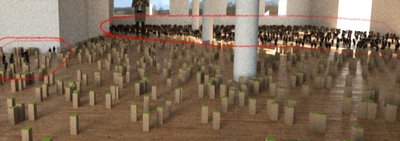

Hi Smicha,
Yes, I did and that is awsome. This example shows only 3 objects used.
For grass or so it might be good enough to use random texture node, but I want different shapes to be scattered mixed... then only the random texture node is not enough.
