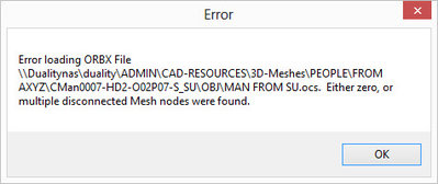

I have been having difficulty trying the OCS proxy feature. I get the 'multiple disconnected nodes' error (see below). But there are disconnected nodes (note that it gives me the ORBX error even though I am trying to use an OCS file). Packaging that OCS file to ORBX gives me the same error. Incidentally, it's the same error I posted about back in November which I think you had resolved back then.

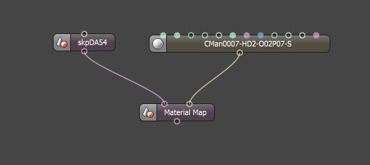

The node structure is extremely simple - see below.

Hi Seeker - there are no disconnected Mesh nodes in the scene you posted - therefore, it will pop a "Either zero or multiple disconnected mesh nodes where found" error. If you disconnect the mesh node from the Material Map - it should be good.

face_off wrote:Hi Seeker - there are no disconnected Mesh nodes in the scene you posted - therefore, it will pop a "Either zero or multiple disconnected mesh nodes where found" error. If you disconnect the mesh node from the Material Map - it should be good.
Got it working, thanks Paul.
The error message logic still gets me... If there are mesh nodes and no disconnected mesh nodes, why is it complaining...?
The error was saying there there was no disconnected mesh nodes found (which is true!).

Hi Paul,
Sorry, man... I am still no getting it! Here's my logic:
Disconnected mesh nodes = bad = error
NO Disconnected mesh nodes = good = no error
The error dialog reports something as a error which is in fact not an error at all? What am I missing?!
Hi Seeker. Disconnected mesh = good. The plugin will load the mesh node from a OCS/ORBX file is it in NOT connected to anything. No disconnected mesh nodes = bad = error.
Ah yes of course... I forgot about this issue with proxies! Thanks for clarifying, Paul.
