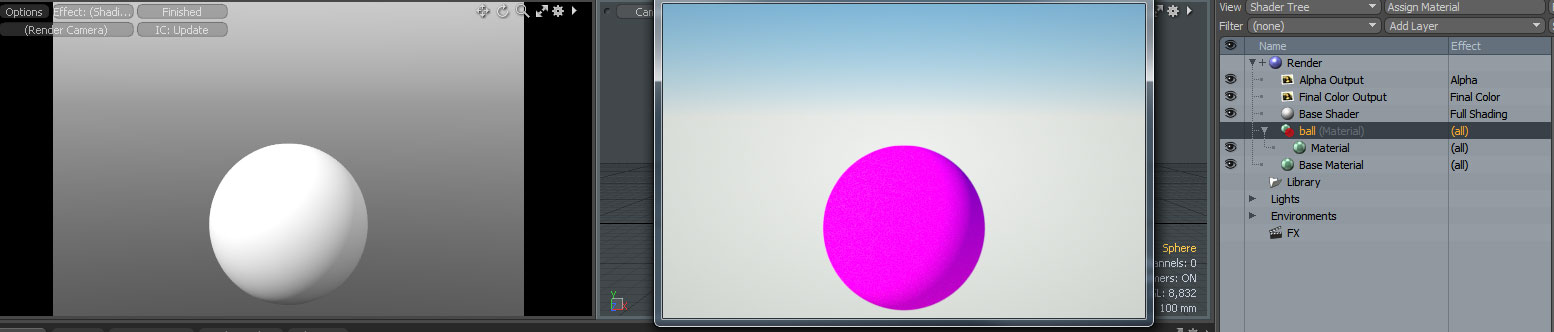

In standalone (and lw plugin), the default environment is set to texture with an RGB color input (it allows you to quickly change the color of the background).
In the modo plugin there's no way to set this up. Setting environment to texture should pick up the color in modo's environment material. I tried the following:
1. I set environment type to constant, and set the zenith color to purple.
2. I tried adding a "constant" layer above the environment material.
Both those methods should work to match the modo renderer and standalone functionality.

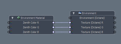

UPDATE: I see that you actually have channels for "Texture (Octane) R/G/B" in the environment channels, but this isnt exposed anywhere in the GUI (why not?).
I can actually hook up the zenith color channels to the octane texture color channels to make this work. Only problem is that it doesnt update in real time. I need to refresh the renderer

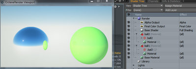

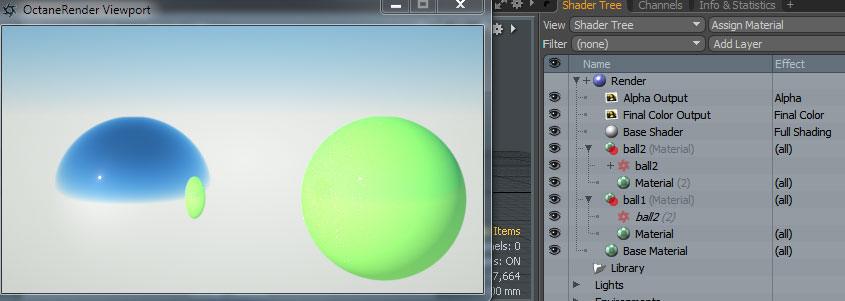

Instances of octane overrides arent updating correctly in the render viewport
1. Add 2 sphere items
2. Give each a different material (ball1 and ball2)
3. Select ball one in the shader tree and add an octane override
4. The setup window pops up, so reselect the override in the shader tree then press "instance octane override" in the setup window
5. In the shader tree drag the new instance to the ball2 material
6. Open the octanerender viewport. Everything looks ok (2 identical spheres)
7. Select the original override in the shader tree and change the settings on the glossy material
BUG: Only 1 sphere updates in the render viewport. You need to force a reload to see changes to the instanced override material

funk wrote:BUG: Only 1 sphere updates in the render viewport. You need to force a reload to see changes to the instanced override material
Yea, it's interesting because the RGB Color nodes will update both automatically, but not the material settings.

the default environment is set to texture with an RGB color input (it allows you to quickly change the color of the background). In the modo plugin there's no way to set this up.
This is planned for implementing in the next release or two. It is probably less confusing if there is an RGB color in the Octane Texture Environment properties, rather than picking it up form the Modo environment.
Editing the Octane Environment channels in the Schematic is not currently supported - but may be implemented in the future. I'm not sure whether having the Environment as a node where you can plug anything into it is better than having a (more) complete "Octane Environment" properties pages (as is currently implemented) yet.
You are right. I think this is because the feeder node (diffuse material) of the source override is being deleted and then recreated (as a specular material) and this is all automated and tripping up the Modo instancing system (since it only the OVERRIDE which is instanced - all the other nodes are actually one set of nodes connected to the input of the source and instance Override). This is definitely something I never considered. The intended workflow is you change the diffuse to a specular, THEN instance the material, rather than instance then change the material type. There is not a simple fix for this - but I will look into it in more detail to see what can be done.

I think there is some confusion (and please excuse me if I'm the one misunderstanding here). I didnt change the material type from diffuse to specular. I left everything the way the override creates it (it created a glossy material). Both overrides are being fed by exactly the same nodes. I just instanced the override and placed it in another material mask.
Here are clearer steps (I hope):
1. In the model tab, in item mode, shift+click a sphere item and rename it to "sphere1".
2. Press m and give it a material "mat1" (using the default color=1,1,1 diff=80% spec = 20%)
3. shift+click a new sphere item, rename it to "sphere2" and move it +1m X
4. Press m and give it a material "mat2" (using the default color=1,1,1 diff=80% spec = 20%)
5. Select mat1 in the shader tree and add layer > custom material > octane override (it should open the octanerender setup window and you can see an RGB color plugged into a Glossy material)
6. Press "instance octane override"
7. In the shader tree, drag the "mat1 (2)" instance above the material layer in the mat2 material mask
8. Click Open viewport. 2 White glossy spheres should render
9. Select mat1 in the shader tree, click the glossy material node, change INDEX = 1, specular = 1
BUG: One sphere becomes mirror/chrome while the other remains white. I dont think I'm doing anything unexpected
If you click the "reload the scene" button, it refreshes and fixes the viewport render so both spheres are chrome
EDIT: I think I understand what you were saying. Your original intention was to set up the material as you want it, THEN instance it and never touch it again... I just can't see any of us working that way because we are constantly changing our minds :)
Would you consider creating nodes for the env/camera/kernel etc? In the standalone and lightwave plugin (which are node based), I can set set up multiple kernels, or imagers and easily plug in and out of them. In modo I have to go in and change the settings each time.
I often have 1 imager set up for linear workflow and another using a camera response curve and find it really handy to bounce between them. I can also set up a zdepth kernel, a material ID etc etc and easily plug in and out of them for different passes.
Maybe we could use modo's render passes for this too, but I would like the option of doing it the way the standalone does too.
