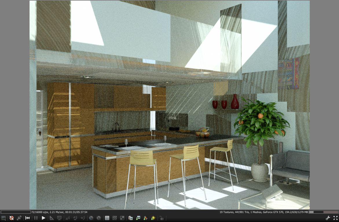

i've got a similar issue, the gpu failed and the ram bar full up with a red color ( it's impossible now not recognised a gpu failure, thanks). with big surprise, in the preferences there was a red allert about obsoleted nvidia drivers.
the strange thing is that before the failure of one gpu, the bar displayed 4 gpu correctly and i have made a lot of tests without any issues.
anyway i have updated the nvidia drivers from 285 to 301.42 and now all works smoothly
ciao beppe
ciao beppe

ashurao wrote: I have the same problem that some users with textures.
I confirm. I have the same issue. As I remember well such "circles" occur when scaling is incorrect. But scaling of my objects is fine. My solution for now is by increasing rayepsilon value.
I tried this solution, but it did not change anything for me.smicha wrote:ashurao wrote: I have the same problem that some users with textures.
Mac Pro 2010 6 cores 3,33 - Mac OS 10.11.6 - 16Go - GTX 780 3Go and GT 640 4Go - Archicad 19 - Cinema 4D R17 Visualise - Octane Render V3
