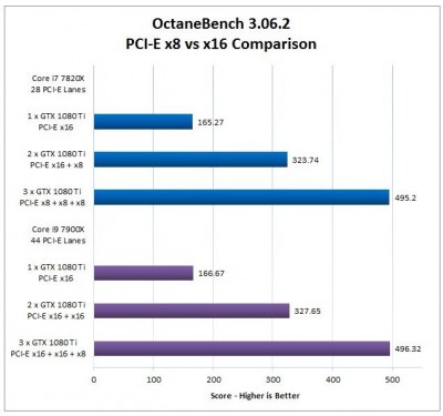

Is there huge impact of available PCIe lanes per GPU? Or only for OOC?
CPUs with enough PCIe lanes are very expensive but come with core count >= 16...and consumer grade CPUs come with a maximum of 24 lanes....though PCIe 4.0.

for each card, 8x of lane width should be good enough for most cases, and you may not even notice the difference to the 16x lanes,
the lane width is only related to how long time your scene data can be loaded into the card, means the time before the card is running on the scene.

seems the 8x and 16x lane at same gen only have 1%-2% difference (maximum) in performance, so no people will really notice that, I believe.
pugetsystem have tested on it
https://www.pugetsystems.com/labs/artic ... ring-1030/

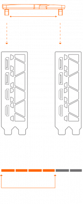

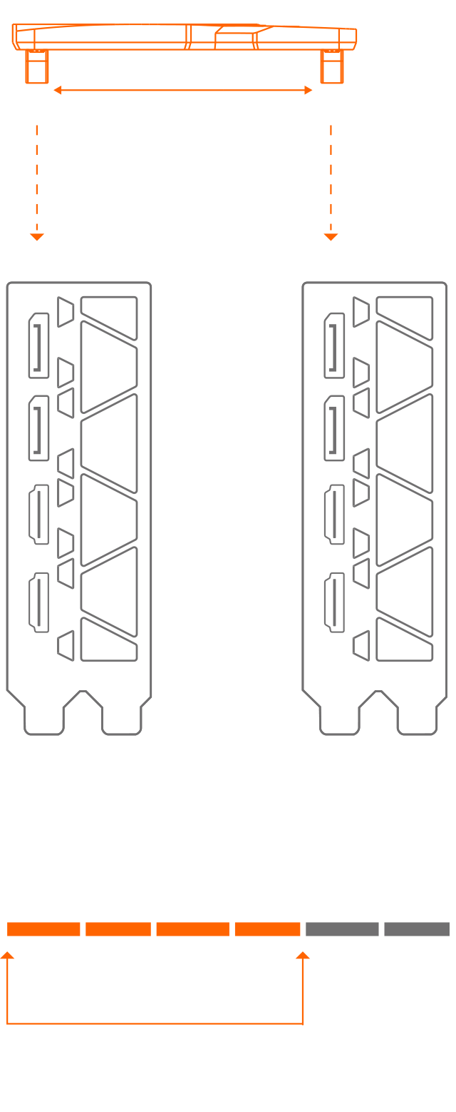

Ah found the picture...was on gigabytes site not on nvidia....
https://www.gigabyte.com/Graphics-Card/ ... BO-24GD#kf
Here they mention only 4 slot spacing for the NVlink...

just hope there is a 2 slot type, like the quadro's...davorin wrote:Ah found the picture...was on gigabytes site not on nvidia....
blower type is specifically for the GPU workstations and GPU servers, which will always be very squeeze in space..

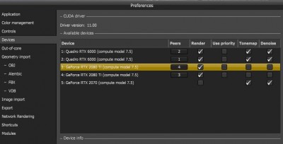

Just FYI in future maybe nvlink could work withoutout the bridge, since nvidia is already published in future it will be Devs to deal with the nvilink by themself, no need throug nvidia driver
for now, I did not put bridge on my quadros, but in octane, they still can be recognized (in condition of SLI is already actived by the first pair of 2080ti)
guess performance will be different with or with out bridge...
