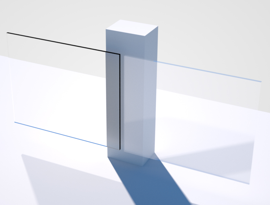

Hi, Pardide. Vectron Lights are not so nice finally... Is Octane daylight an Octane Light or an Octane Light vectron ?
I used in older version fake glass, but no more : it tend to be whiter, and are lightened by light.
( specular left - your orbx material right )

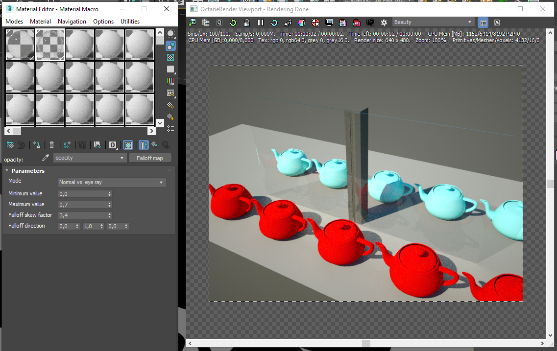

Hi HHbomb,
you would adjust the falloff in opacity slot.
Regards
Paride
falloff.rar
(1.55 MiB) Downloaded 238 times
